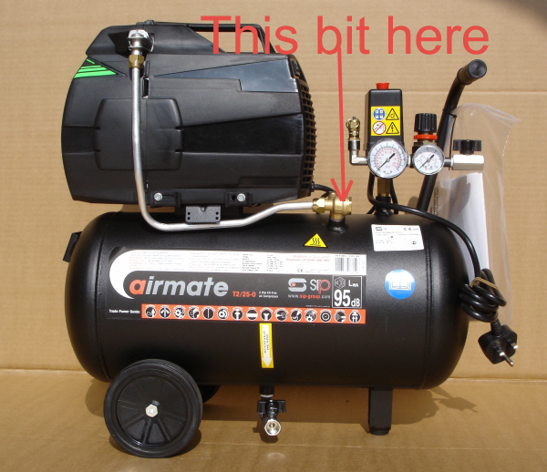

Hello to all I am new to here and not such a dab hand with a computer. I hope you can help me I own a AirMaster 15/60 and the problem is it fills up to 150 then blows off but continues to blow down to around 120 where the motor tries to kick back in but does not seem able to turn the pump over so blows the fuse every time. when the pressure is down again and new fuse inserted the cycle repeats, it may be an easy one to some of you but I have know idea, would much apprieciate any help thanks Ian.
