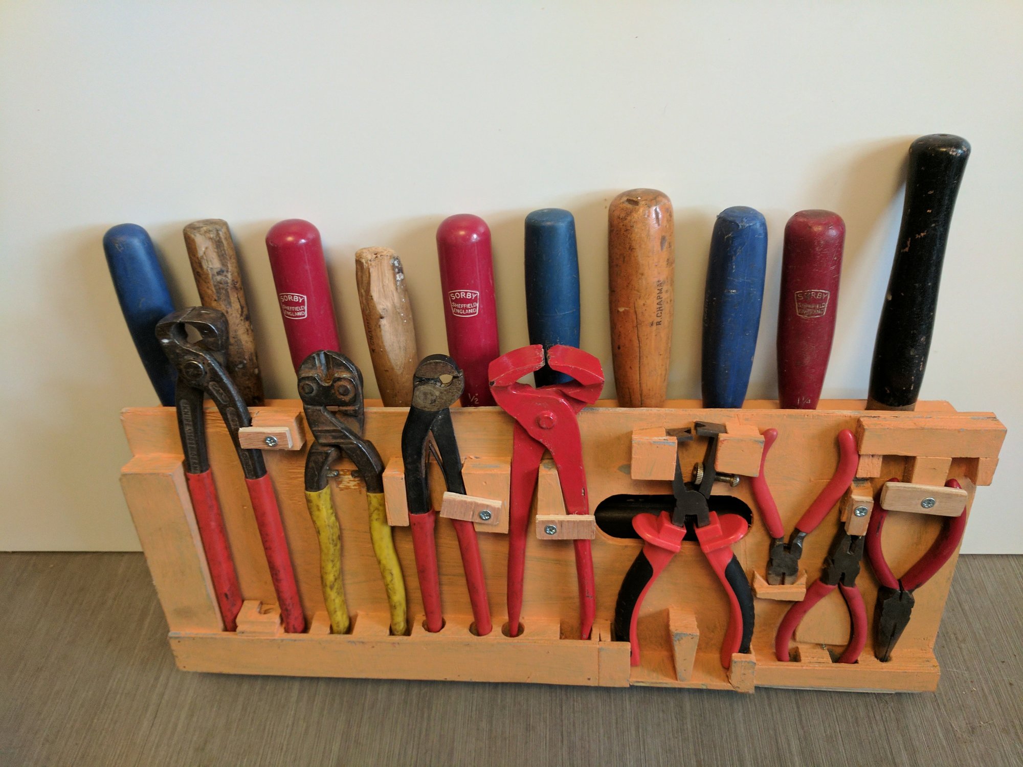

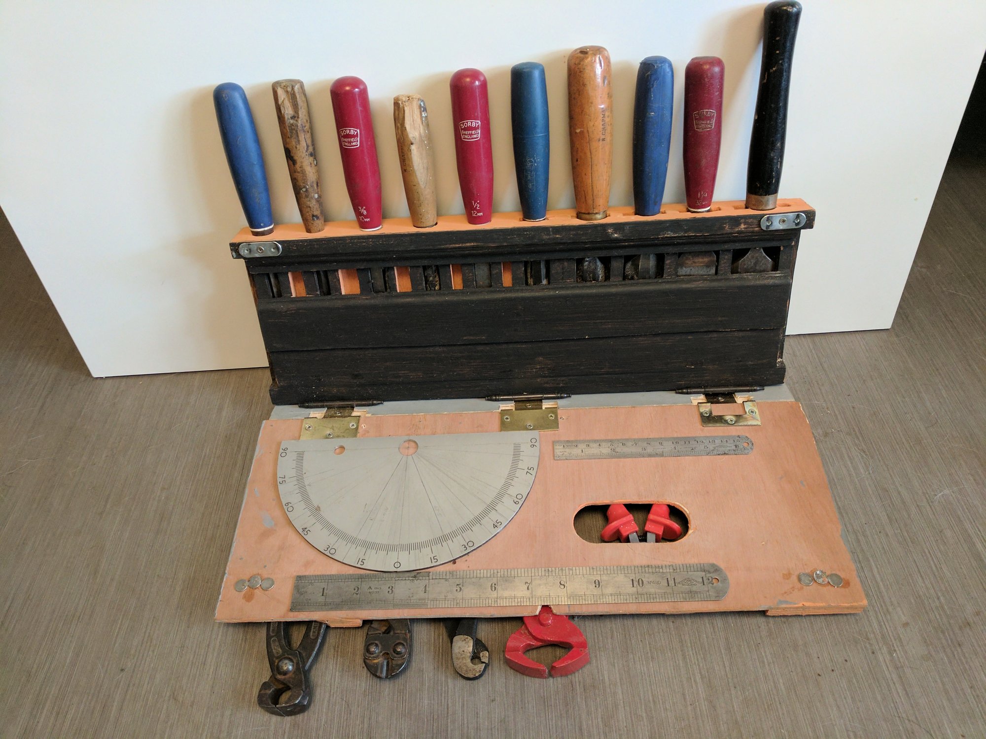

I've been working on this on and off (mainly off, and mainly in my head) for about 5 years.
It's going to be a complete tool cabinet which has individually hinged tool "modules" which swing up, down or out to allow multiple layers in a small space.
The cabinet is made of two boxes 39" x18.5" x 4.5" internal dimensions, hinged along the long side so it closes like a book.
These are the first two modules I've made, and I've made a (rubbish) video showing how I intend to layout the third.
