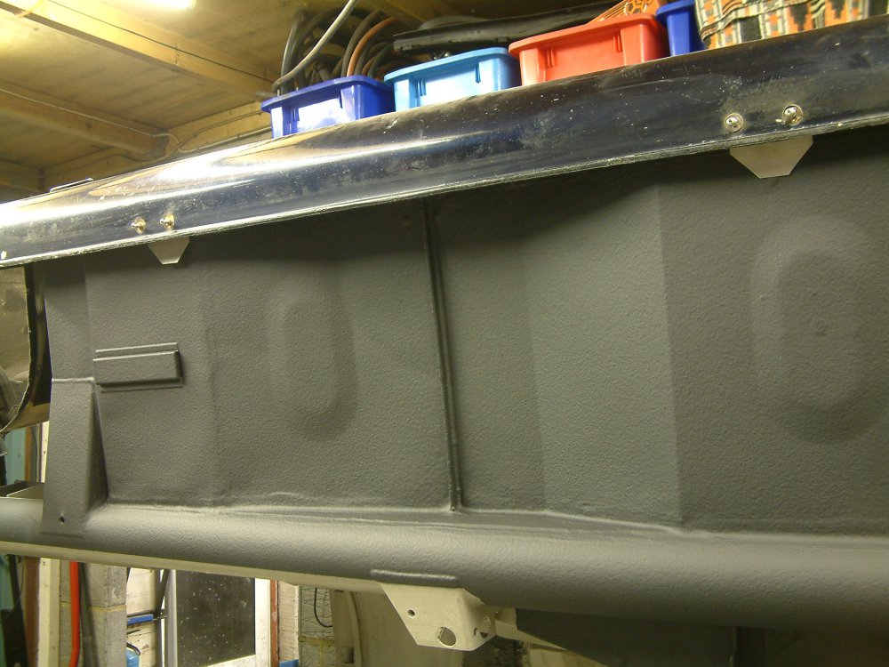

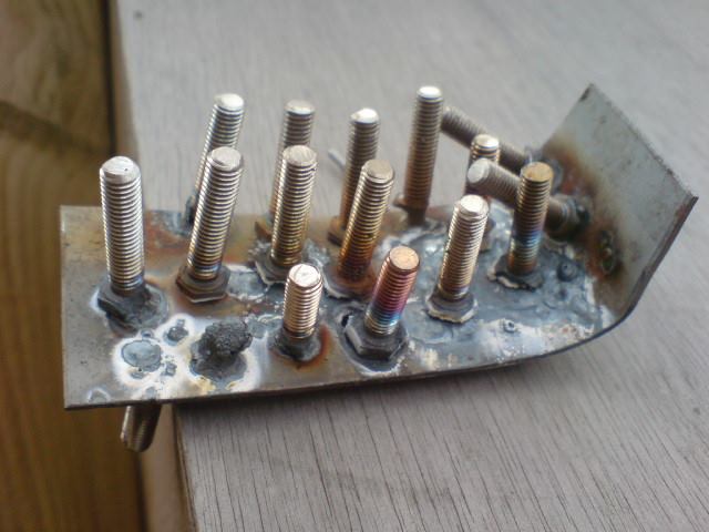

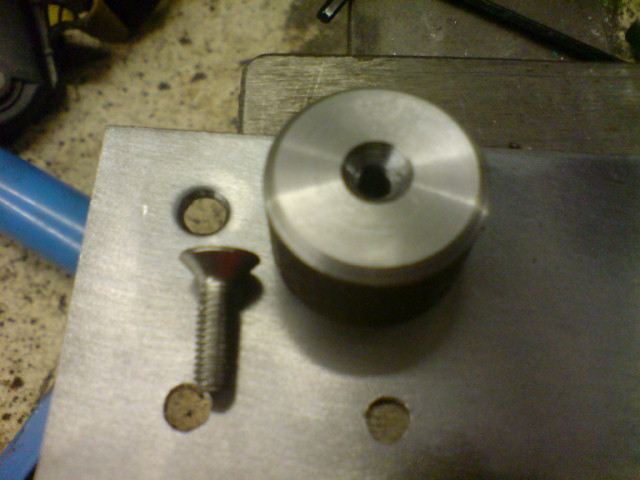

on the boot lid of my Triumph Herald, I need to secure a new supporting frame to it made from 16mm steel tubing, so I decided I will use 16mm P clips to hold it in place. to secure the P clips in place I need some M5 studs welding to the boot lid, but I need minimal distortion due to heat. I came up with the following idea.

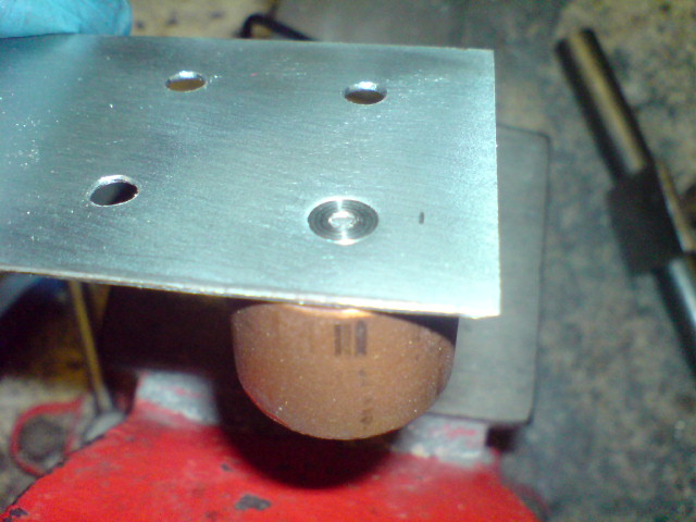

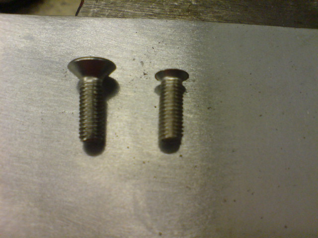

get a bit of steel bar, tap it M5 (in my case) and then countersink the end to use as die for flaring a hole in the sheet metal and use a countersunk screw to form the flare (as shown on the hole above the screw)
turn most of the head off some more countersunk screws

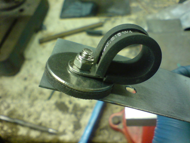

and put them into the flared hole with a copper heatsink (I used a thor copper hammer blank) with a threaded and countersunk hole as the steel die.

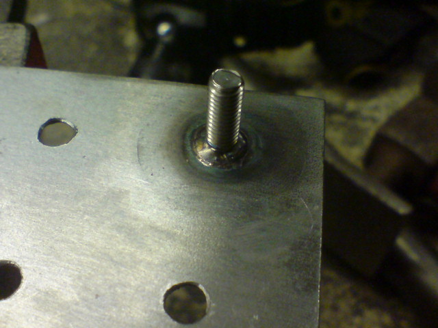

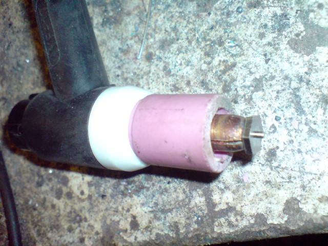

then tig or mig weld the screw to the steel sheet. (tig in my case and after wire brushing) and with minimal distortion
and the reverse,with minimal distortion due to the heatsink. its is tapered around the base of the thread due to the flaring of the sheet metal

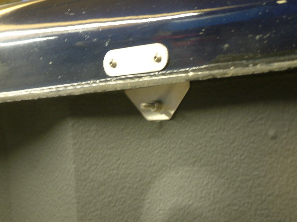

and assembled with a p clip and washers
just need to do about 20 of these around the edge of the boot lid now
