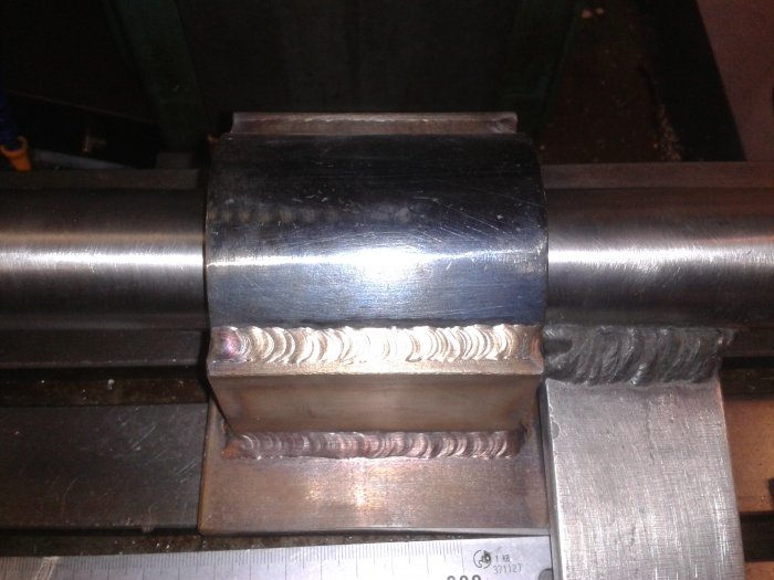

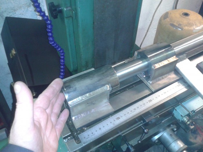

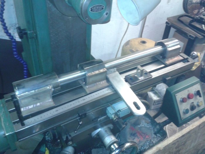

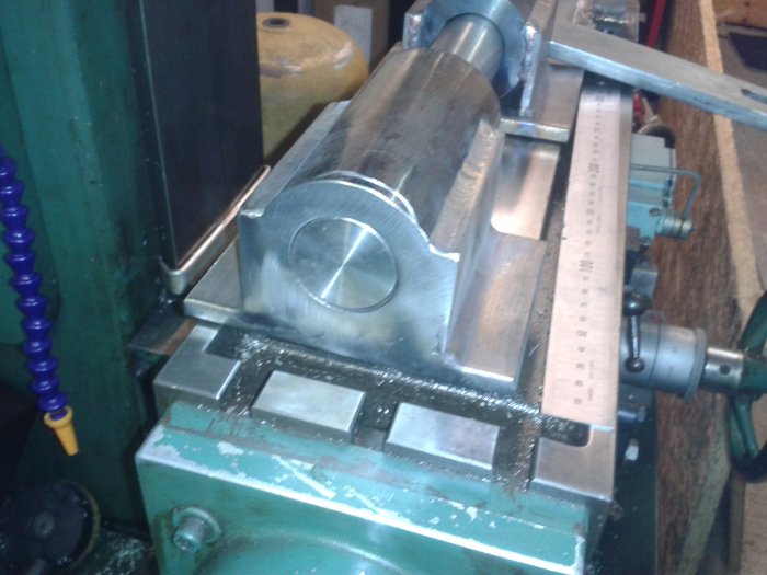

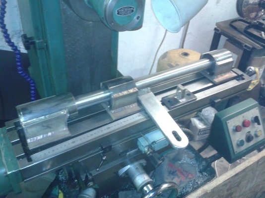

I was asked to make this a few weeks back , i didn't really want to do it as i had enough on my plate , anyway it is a door bolt for a strong room, the bolt is 40mm 304 stainless, it took some heat from the tig to straighten it after i had welded on the handle. The entire thing is tigged apart from the handle to bolt weld which was sticked.
but the hasp and staple for the lock looks vulnerable?
