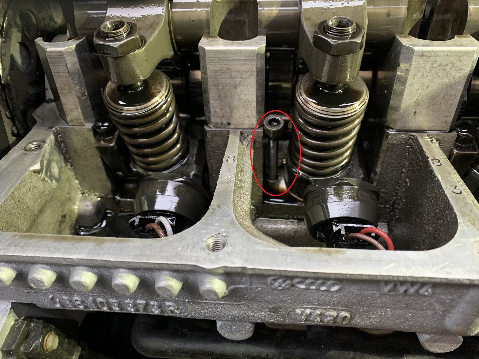

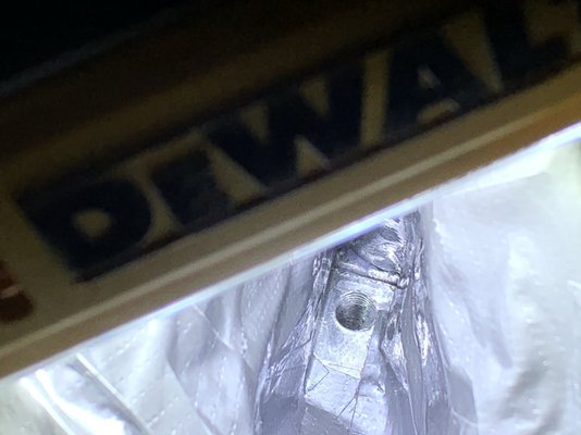

Barlidge Member Messages 1,064 Location Langford, Bedfordshire, UK Jan 5, 2021 #21 Ashley Burton said: @Barlidge What is the torque spec? Click to expand... 12Nm + 270 according to TIS.
Ashley Burton Member Messages 5,123 Location Northamptonhire Jan 5, 2021 #22 Barlidge said: 12Nm + 270 according to TIS. Click to expand... Sounds similar doesn't it
E EEEK Member Messages 42 Jan 5, 2021 #23 Many moons ago I repaired a bodged merc 2.7 .....ended up tapping the hole to 10mm. Made my own insert by drilling up the middle of a 10mm bolt and tapping for original bolt....the proper torque wasn't much and all worked ok in the end.
