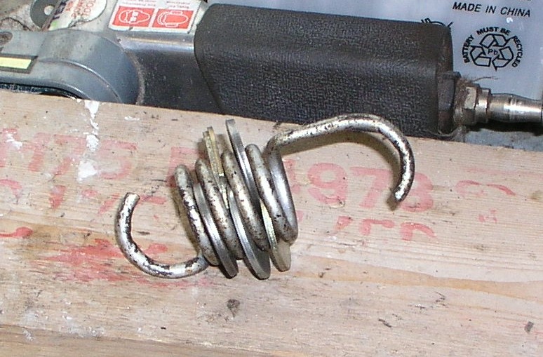

After skinning my knuckles trying to locate a very strong centre stand spring, I came up with the idea inserting spacers/thick washers in between the coils. Worked a treat, just hooked straight on then just removed the washers. I'm sure some of you guys will already used this method but it may save someone struggling.
