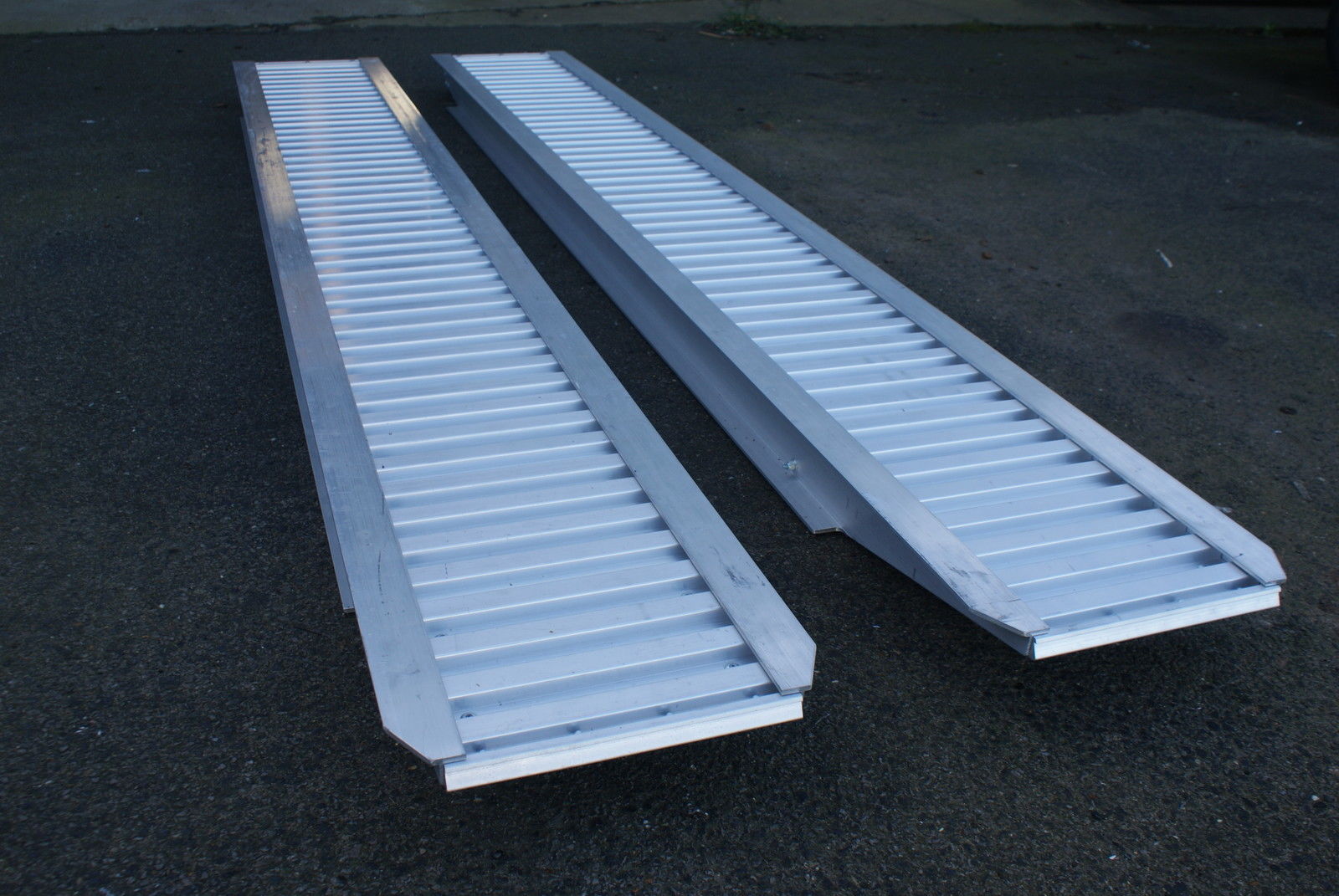

looking to make a set of aluminium ramps similar to what they use for loading machinery,i would like the profile to be as small as possible and i have found some manufactures that say they can supply a set with a profile height of 120mm that will support 3ton at a maximum span of 3500mm what wall thickness would this need to be ? they consist of two c sections per ramp with aluminium plank extrusion welded between them to give the width.
could it be made from 100mm profile c section with maybe 3 lengths to compensate for the profile reduction as i only need them to support a max weight of 2.5t so 1.25ton per ramp at 3500mm they will be a similar design to the picture
