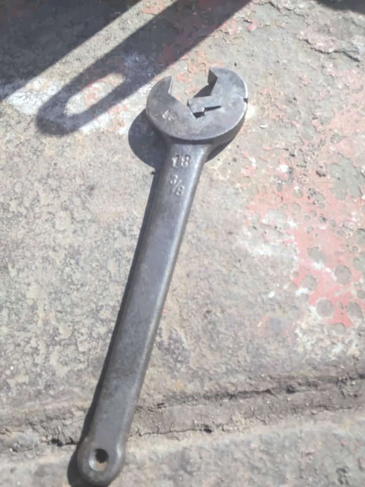

sardine Member Messages 3,743 Location Buckinghamshire Today at 12:06 AM #1 What is this hinged jaw spanner for ?
Erie Fred Member Messages 6,885 Location Erie, Pa USofA Today at 12:22 AM #2 Maybe an early attempt at ratcheting ?
Olderisbetter Member Messages 4,029 Location Wolverhampton Today at 12:31 AM #3 Could it hold the nut while you start the thread?
zzr1200 Working at 650 ft on open steel work. Messages 6,781 Location Glapwell, Chesterfield, Derbyshire, UK 46 minutes ago #4 SP stamped into the side of the head gives the game away... 68100000 - Ratcheting Line Wrench Set 8-15mm (4pc) Durable 4pc ratcheting line wrench set with pressure-lock grip. Perfect for brake, fuel, and hydraulic lines in tight spaces. Built for pro performance. sykes-pickavant.com
