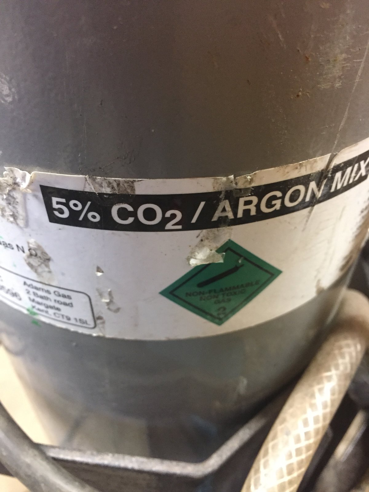

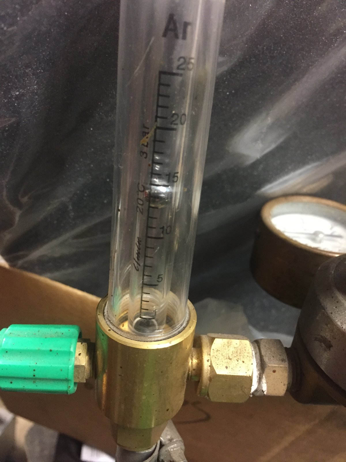

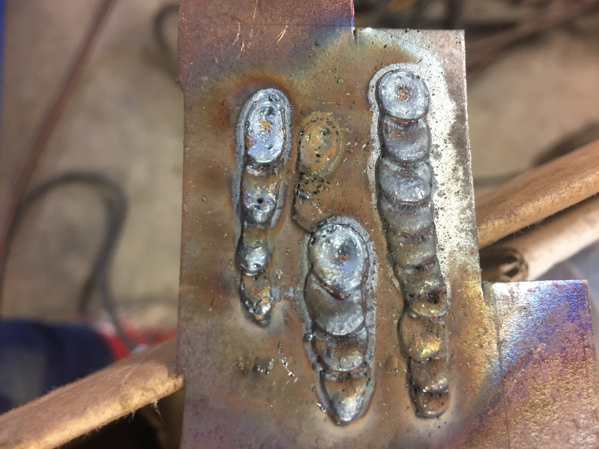

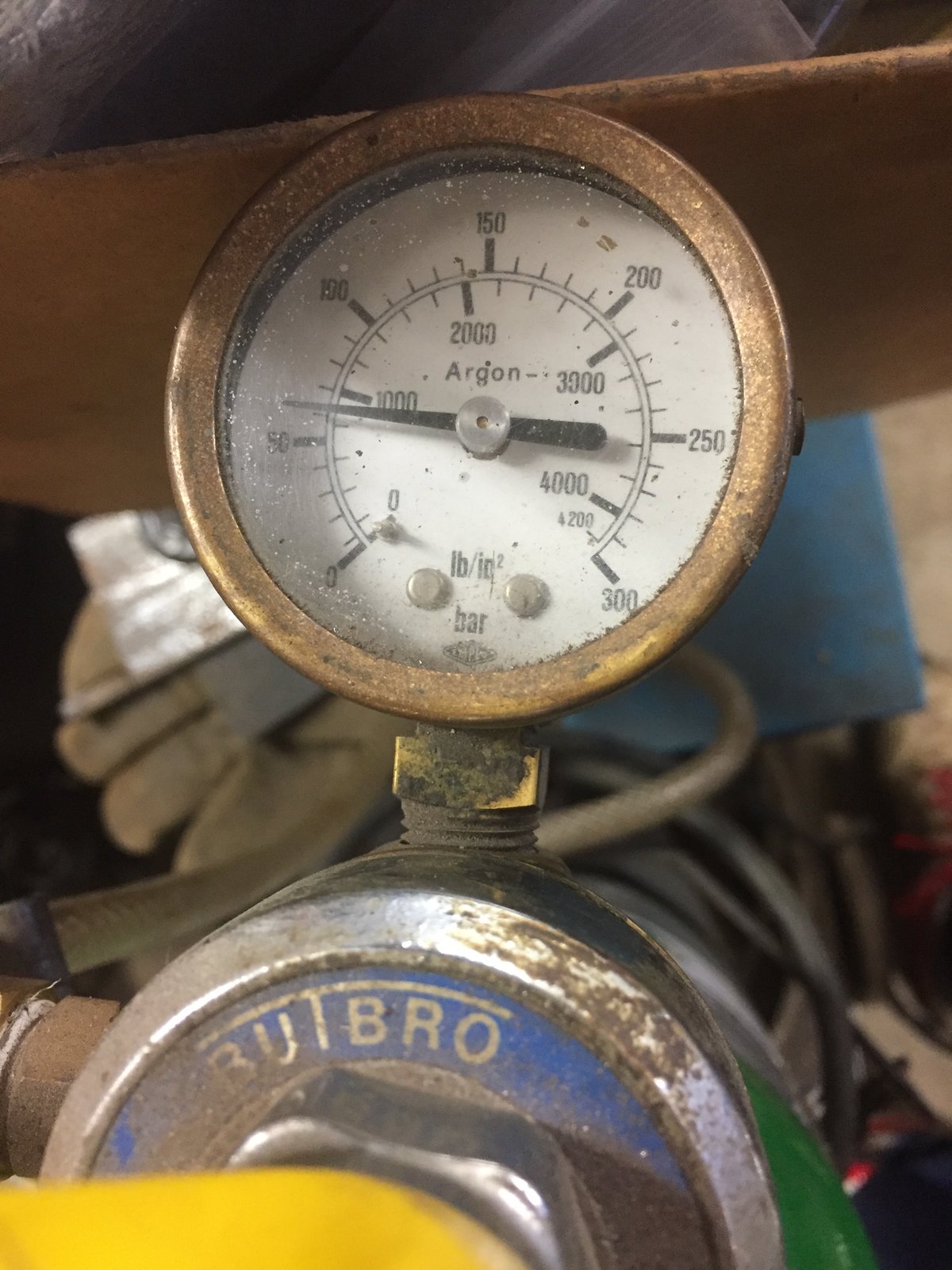

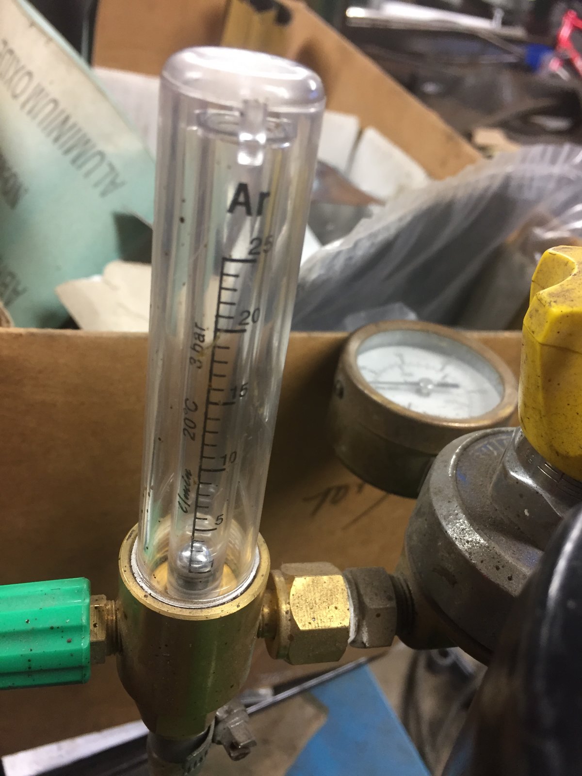

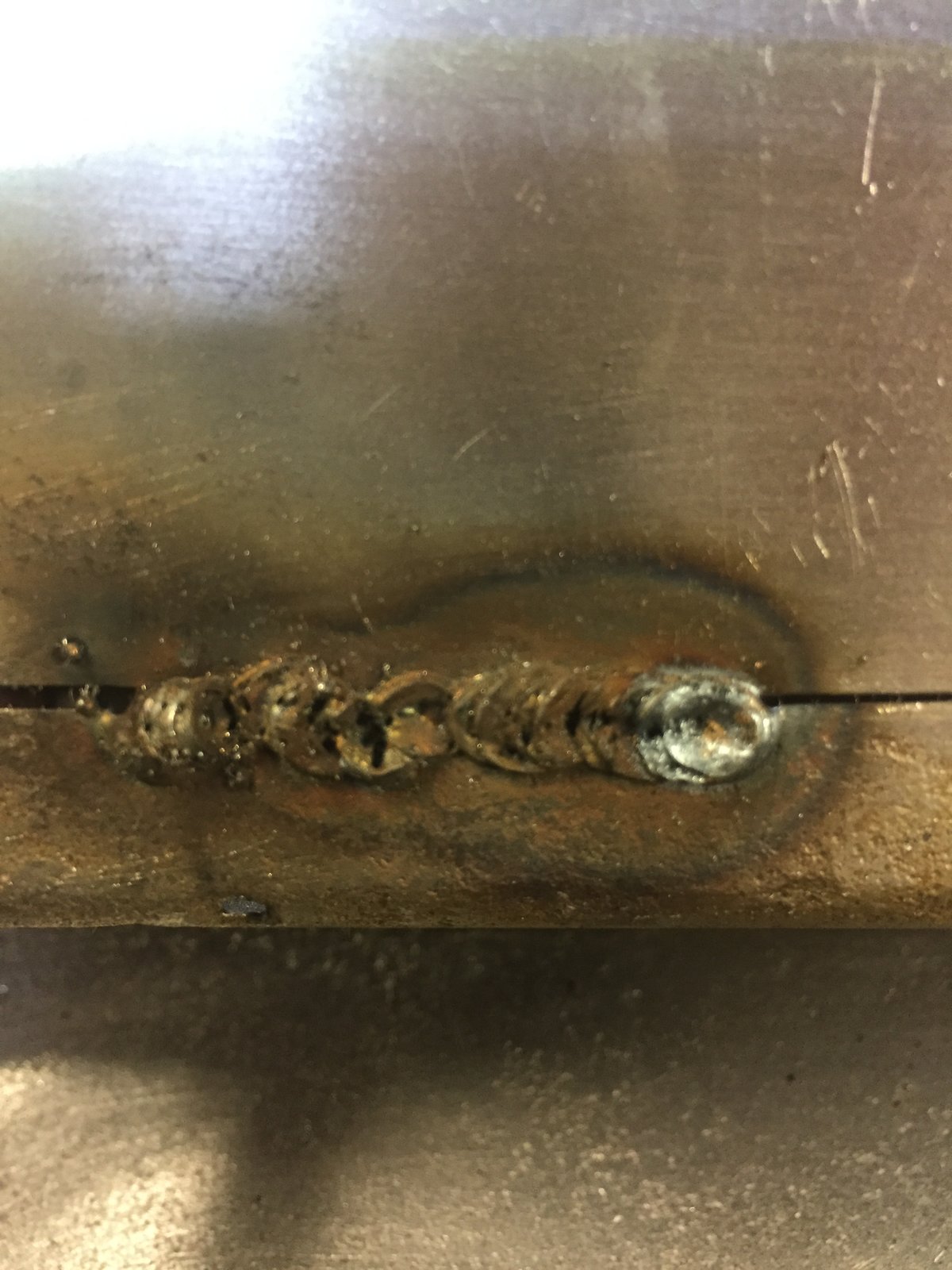

I have an Eland 130 MIG and for some time, especially first weld out, it looks a spluttered mess with pin holes as though no gas. But I have checked gas and regulator/ flow meter setting at around 10 cfm and always run gas through before welding and fresh wire. Audible sound of gas is present at gun.
Today I connected the earth directly to a piece of 0.9 steel and same result for a while. Turned gas off and welded with almost identical result as you would expect. Turned gas on again and suddenly fine! Any ideas what might be causing this fault please?
