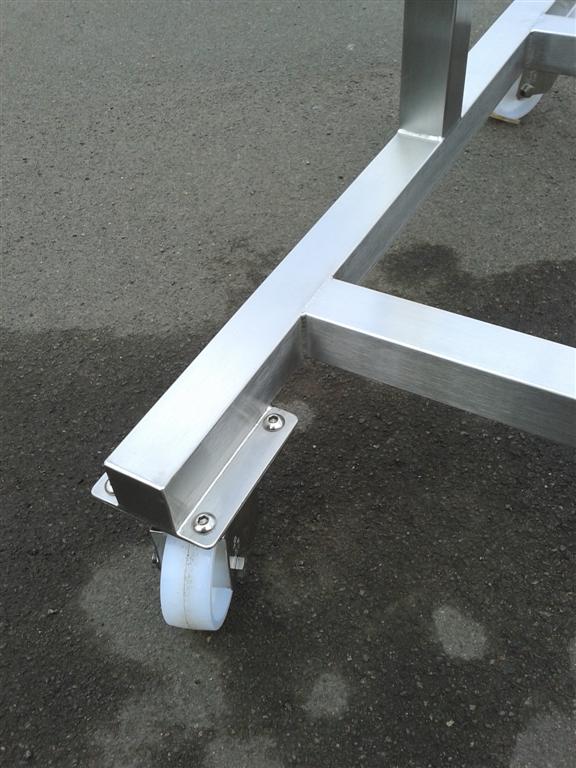

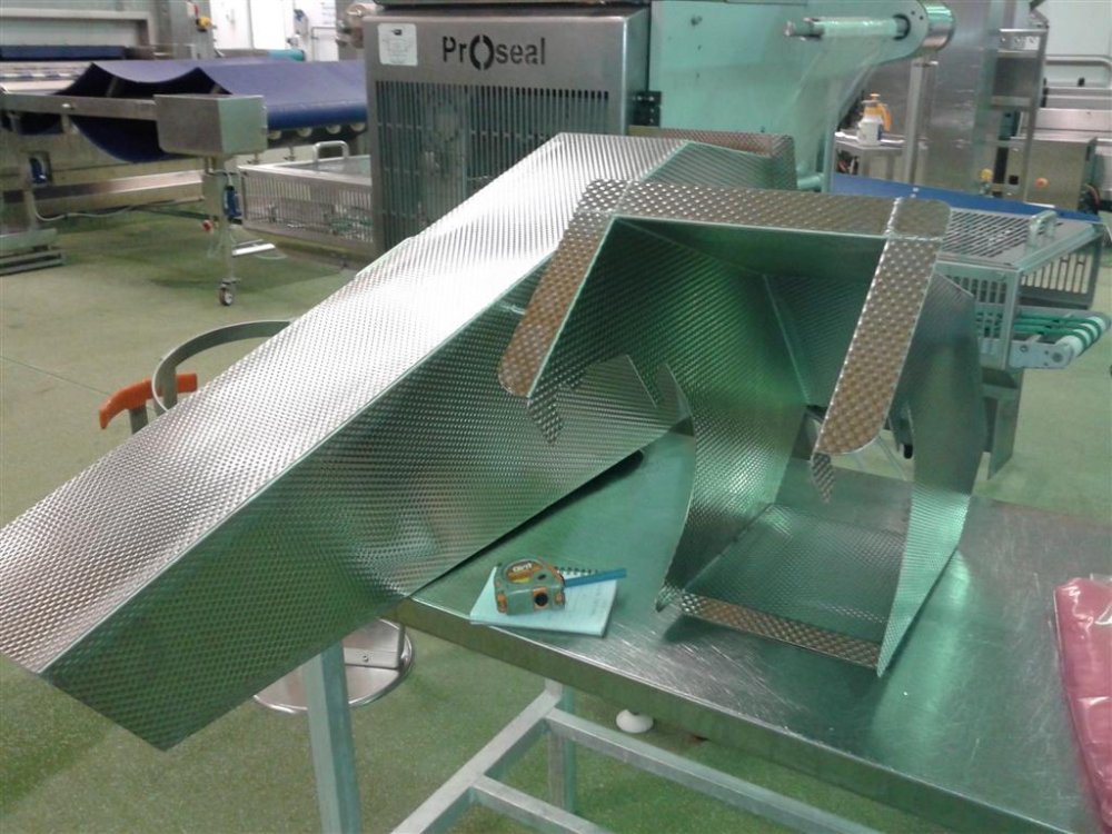

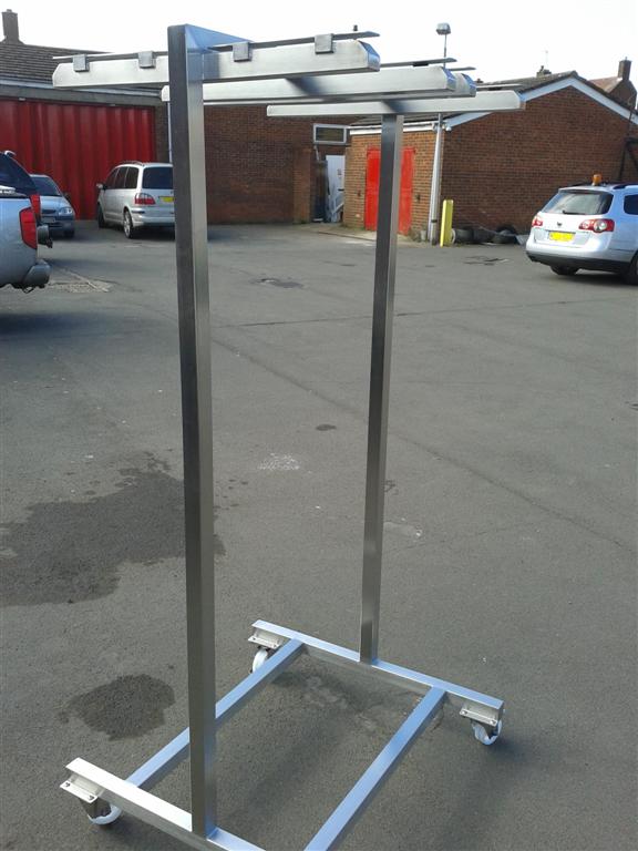

Another small stainless job, customer needs a frame to store these conveyor chutes, and to support them for wash down,
so a simple stainless trolley which enables them to hang from the mounting flange,
40 x 40 stainless box section with a 40 x 3 flat over the top to retain the chute in a slot
