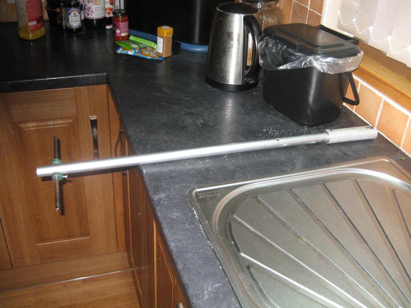

Like all of us I'm getting older each day , now at almost 75 yrs old things ain't quite like they used to be . A bust shoulder , artificial left knee and damage in three places of my spine has severely curtailed how I go about doing things.
50 yrs ago I'd simply hang on the worktop and reach down into the under sink cupboard and turn off the incoming main water tap .
Well it don't happen anymore .
Now my lass has been struck with severe MS ( last year ) neither of us can turn the darn thing off .
So having had our ceramic disc taps killed when the water board flushed the mains a few weeks ago and kicked up loads of iron sediment etc. , I had to make a device to get the water off so I can change the ceramic cartridges .
The first lash up failed miserably , as it was just a T piece on a broom stick with two prongs to turn the tap handle ..it kept slipping off .
So back to the drawing board , then the mancupboard , got an old scrapped awning rail , a bit of 1&1/4 " OD thick walled alu. tube and a nogging of inch round alu bar from a dismantled project of yesteryears pond netting cover ( bloody mink ate all my big Golden Orfe so no point in having a pond anymore ) .

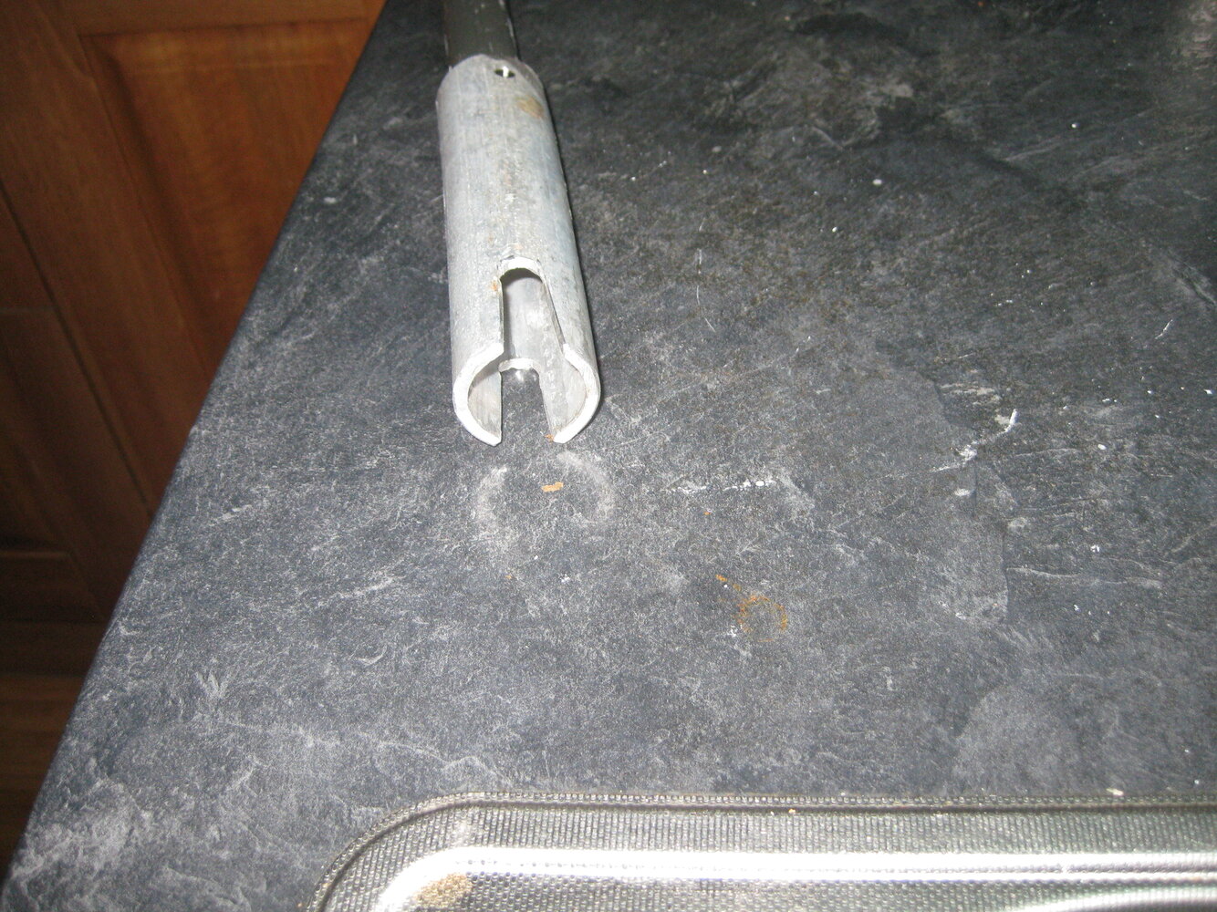

I drilled right through the 1.25 " tube about 2.75 inches from the end with a 10 mm drill then cut 1 mm to within to the inside of the drilled holes in a very gentle Vee s so it has a kind of keyhole shape to both holes . Filed it up and did a test fit over an external bib taps handle . Yea it works and holds on with no slipping off . Then made an adaptor out of the noggin of alu. to fit the tube to the awning rail , also putting in a sliding T handle . Total length just over a metre
Note well . my wive wishes to inform all of you that I cleaned the sink and plumbing tool after the picture was taken
