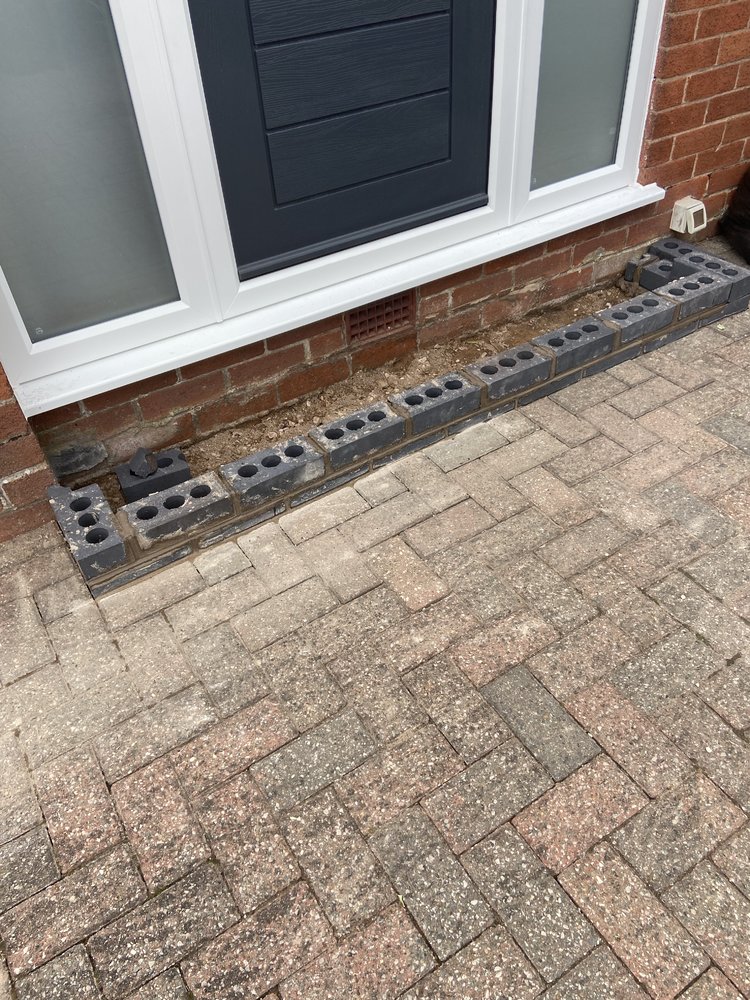

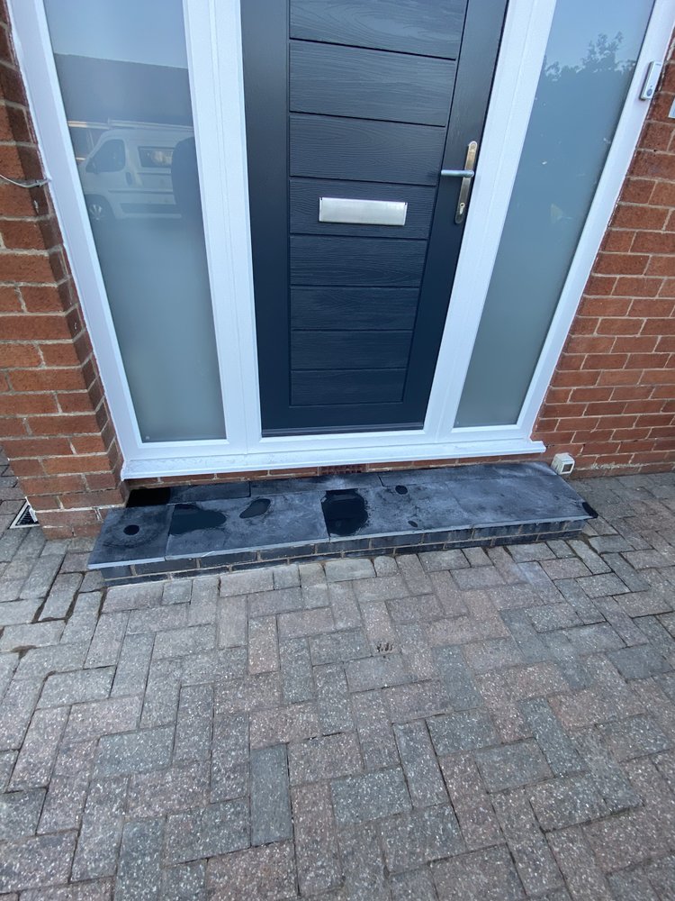

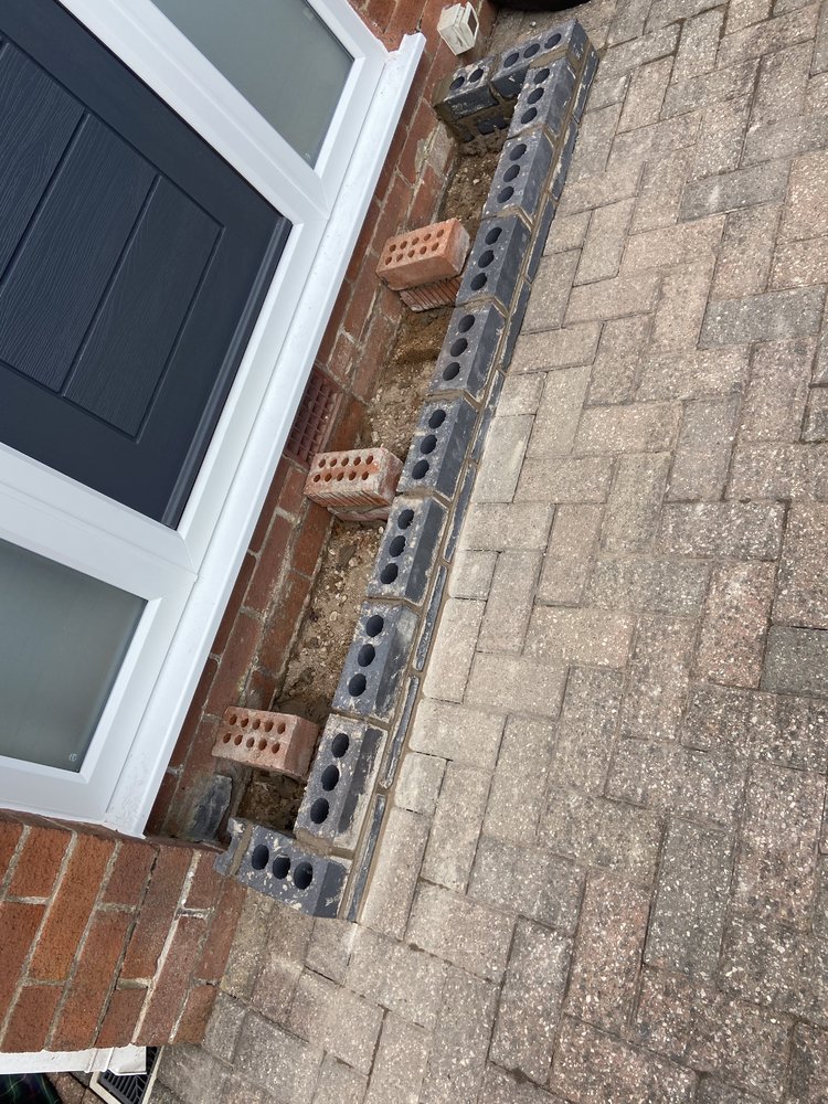

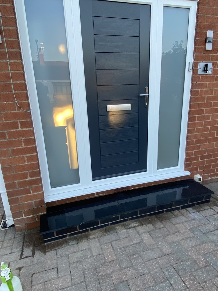

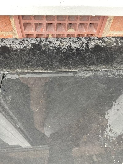

I was asking for sealer recommendations not critique but thanks for your usual uninformed and less than helpful input anywayone major issue your going to flood the air brick full of water
it would be better to higher the step even higher and allow air flow to go under the step and into the air brick under the step
in this case you have blocked the air brick off as well as allowed chance to flood above your damp coarse layer
other wise than that a nice job
the other issue is everyone will stand on the edge of the door frmae they tend to just do it even when your stepping into the door this will damge your rubber door seal
Thompsons Ultra on my stone cottage.My pal has used Thompson’s one coat, he pretty impressed with it so far
