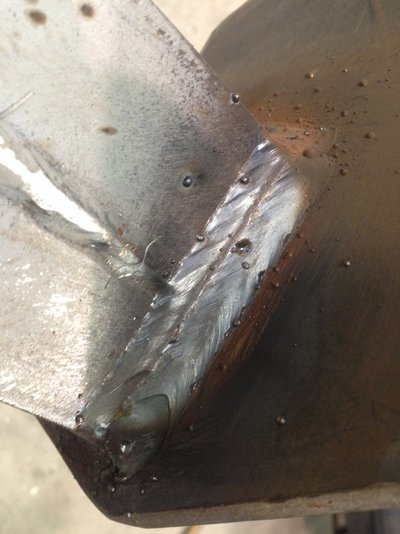

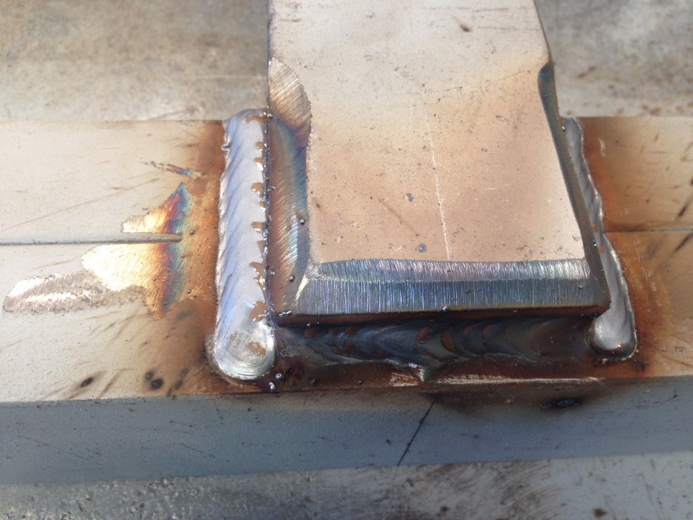

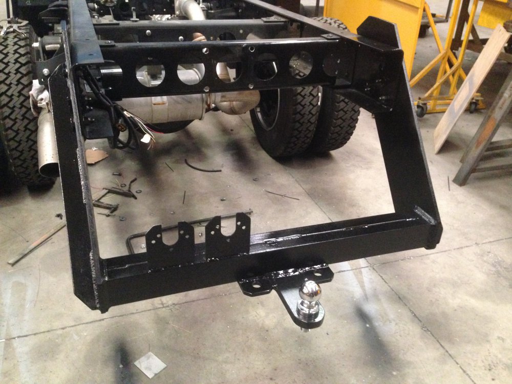

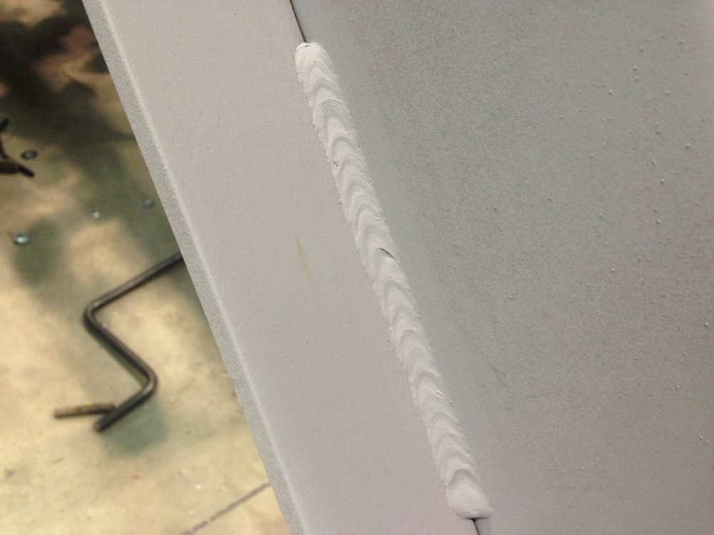

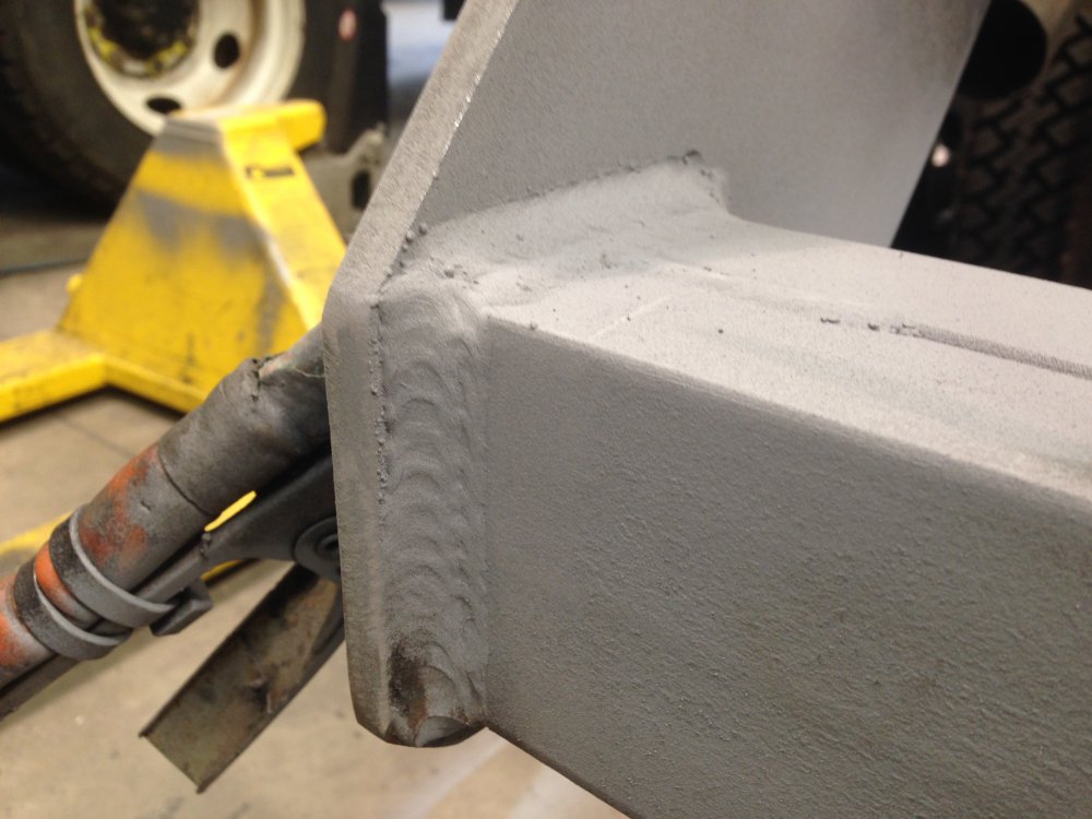

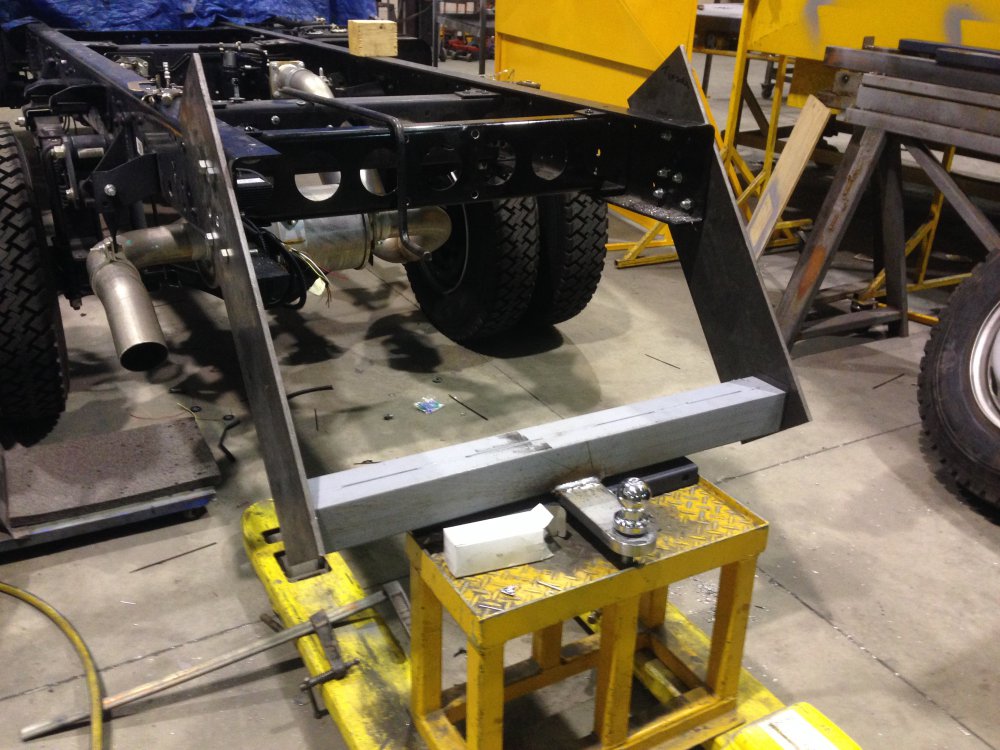

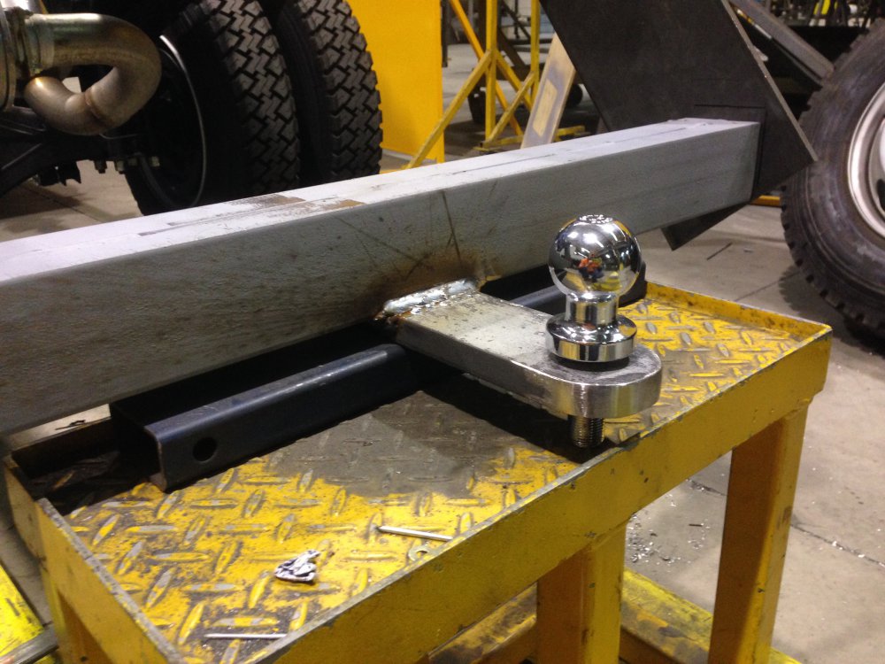

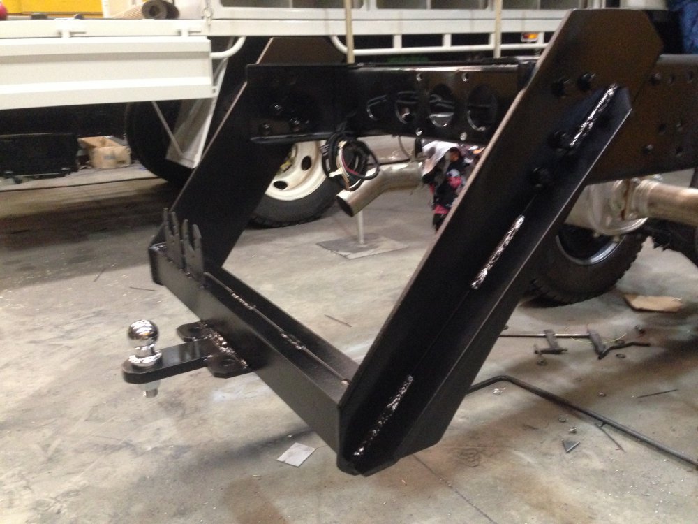

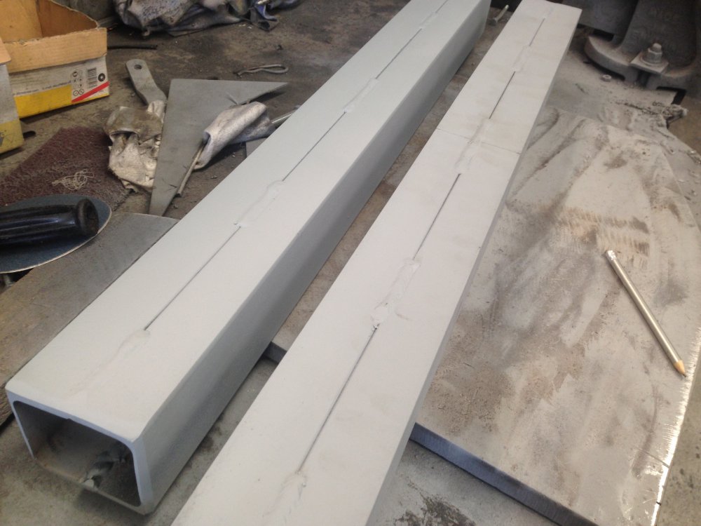

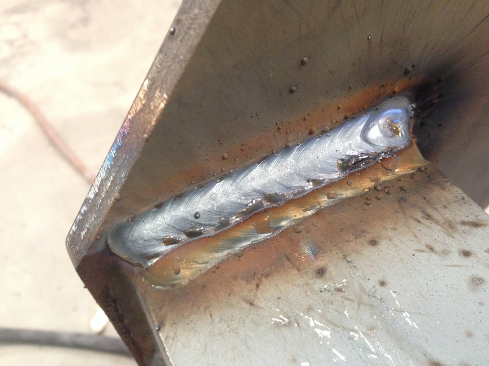

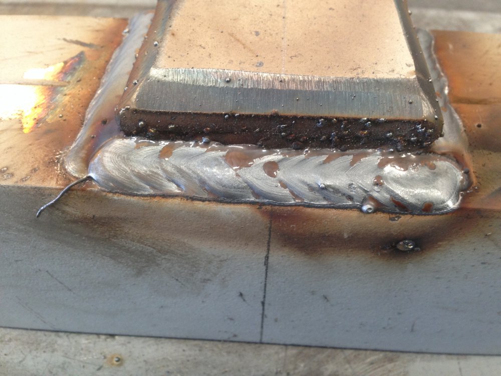

Here is a picture of a towbar fabbed, fitted and eventually painted all done from start to finish, by myself
Designed to carry a maximum of 3.5 ton tested to around 6 ton. I have another 5 to make.
The design is of a 8 ton towbar with the re-enforced gussets down each leg of the towbar, the whole thing is overspec, for queensland rail road maintenance, they put a lot of demand onto their vehicles, so the tow ball tongue is 20mm plate made by me, drill to 7/8 or 22.50 mm , the side plates or legs as I call them consists of 180mm x 10 plate cut to 700mm length and the gussets that run each side to strengthen and reduce any side movement are 50 x 10mm bar @ 600mm length.
The whole thing is anchored to the rear with 10 X high tensile 1/2 inch bolts as no welding is permitted on these chassis. (that sucks)
