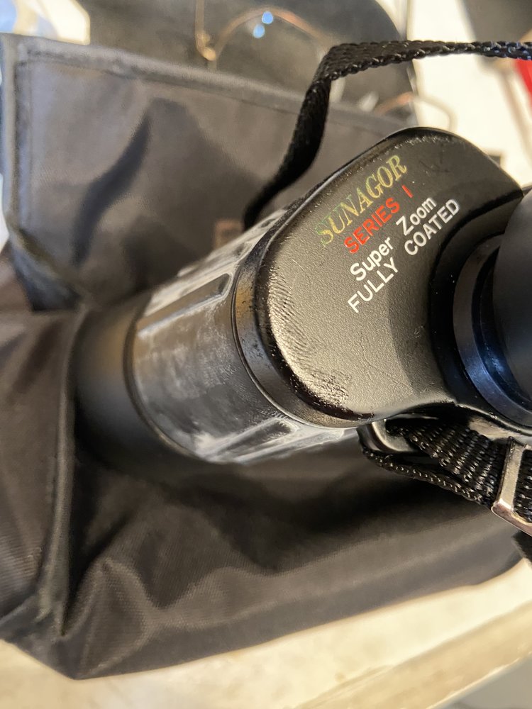

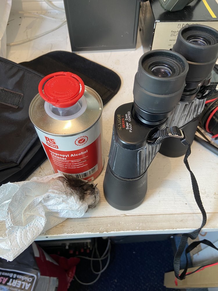

I wouldn’t use neat acetone on plastic or rubber.From reading the thread title, without reading details, I was thinking acetone.
Dunno, does the manufacturer have replacement rubbers, is my thoughts ?
beer that seams a waste better drown your sorrows at a loss than put it on the rubberTry IPA.

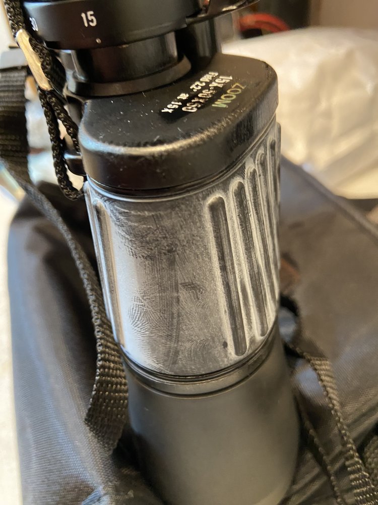

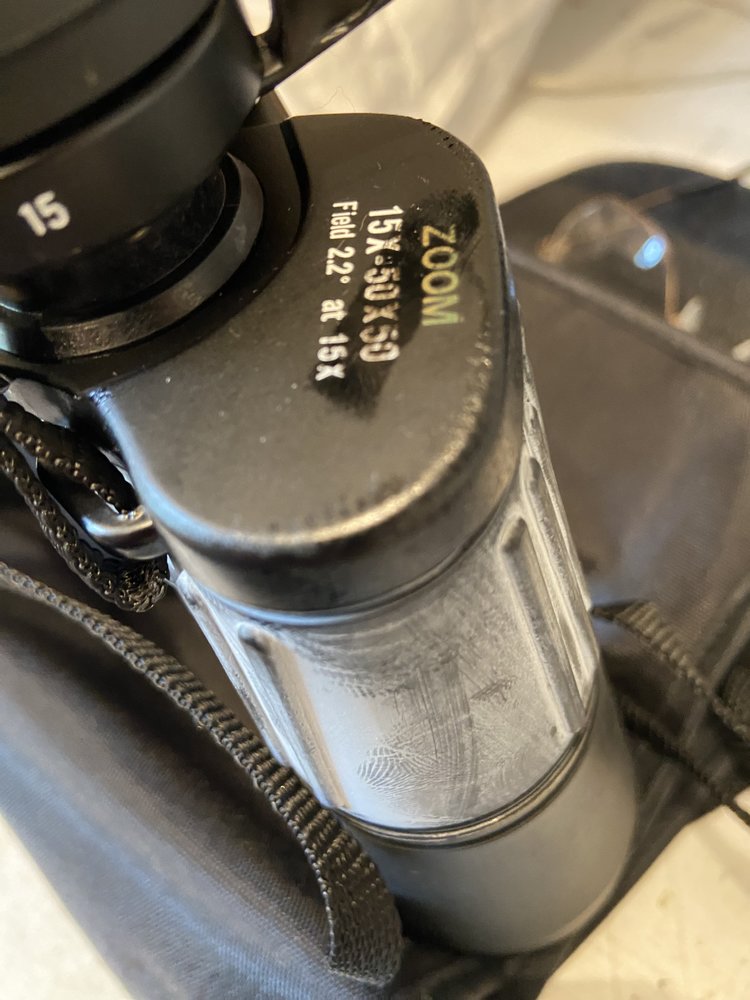

I totally agree. My old Nikon D70s camera and centre console on my E46 M3 are coated with a rubberised tactile coating but it degrades into a horrible sticky mess.If it is one of those "soft touch" plastics, which have a matt, slightly rubberised soft texture - these are very common to degrade over time and go sticky.
You can salvage the item by cleaning the residue off (I've used white spirit and IPA in the past, with a lot of scrubbing) - what you will be left with is just the base shiny plastic underneath.
Its a lot harder if the coating hasn't totally degraded, as it will continue to stay sticky until it has all been removed.
I know they do it to add a "premium" feel, but I really wish they wouldn't.
I'd rather have a basic chunky textured plastic that is robust and easy to keep clean.
