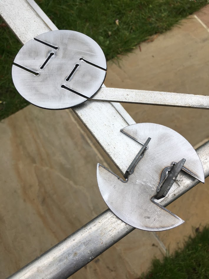

Over the years the plastic feet on my stepladder have 1) broken, 2) disappeared or 3) been left in some soggy ground. So I decided to "do something about it". This is what I came up with and it works just fine. OD of circles is 80 mm. Upstands were drilled to take 3 mm pop rivets as were the legs on the stepladder.
