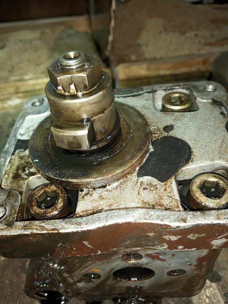

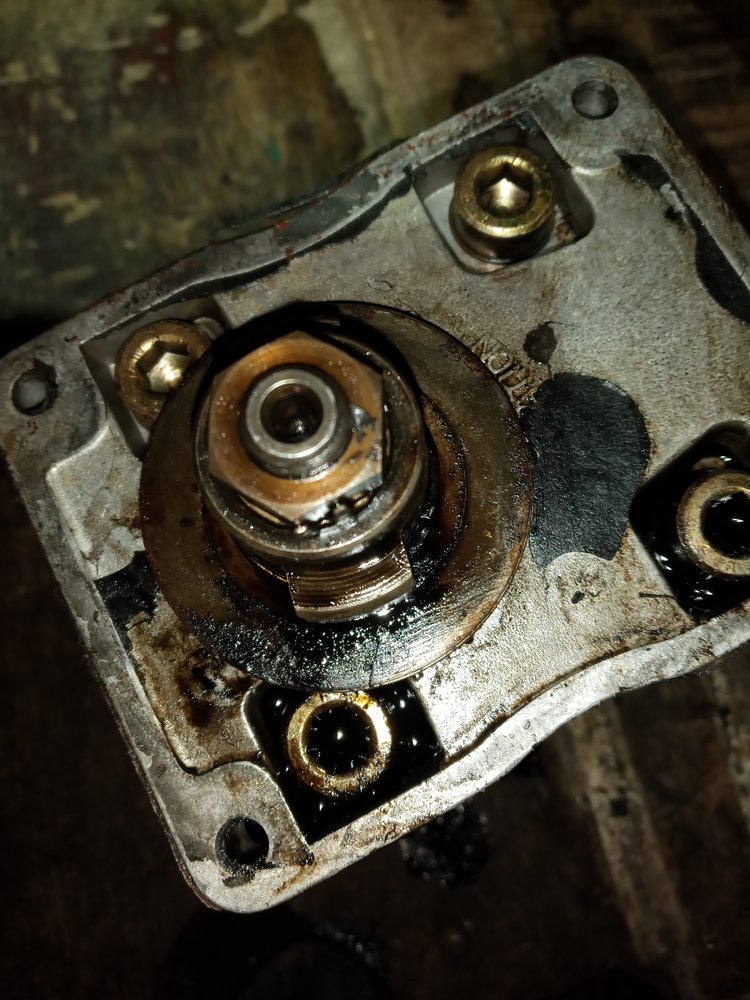

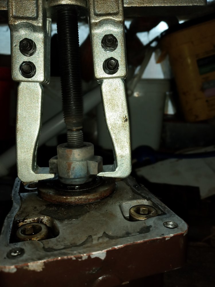

I don't think you can get much more pressure from the jaw type, the splitter type can be rigged (there are tapped holes)Sadly I havent access to a big press , but good to know a bit more pressure and heat might do the trick.
This is on a Fiat 80-90 tractor.
Leave the nut on loose, I've spent many an hour rooting around the workshop floor under benches looking for bits, that have shot off into the distance........Thanks I will have a go with a small persuader tomorrow.
