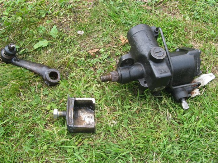

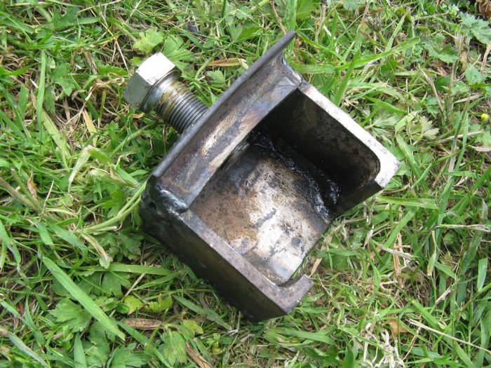

Built this to remove the drop arm from my landrover discovery as I needed to swap the PAS box over and the replacement came from a range rover.
Design was roughly stolen from a transit van forum with the measurements then made to fit the discovery.
It worked neatly, after a little bend when I first wound it right up, a tap with a hammer and the joint just fell apart. After that it didnt bend anymore on the second box and works nicely.

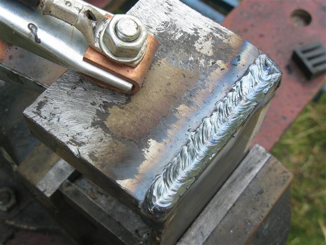

Plus I got to do some arc welding...welds ok?!
Saved me the £140 LR charge or paying a garage to do it for me, esp when I had two boxes...
