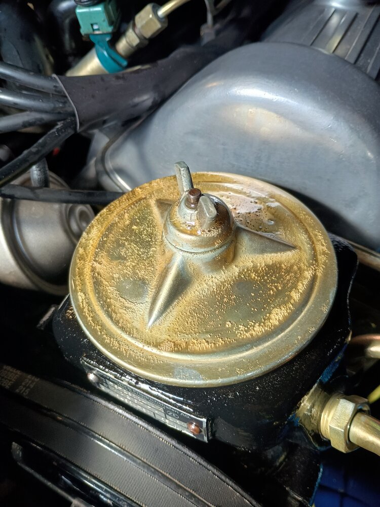

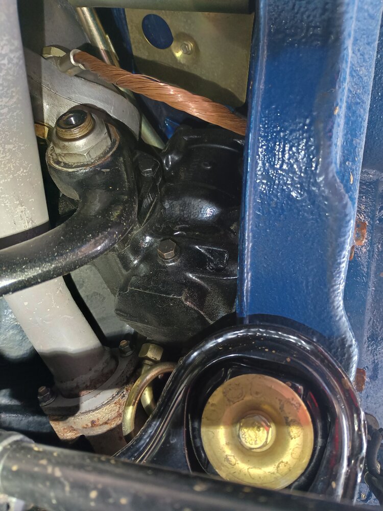

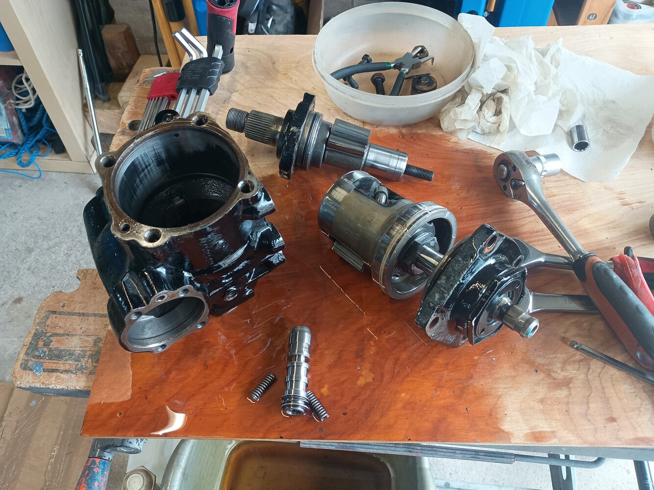

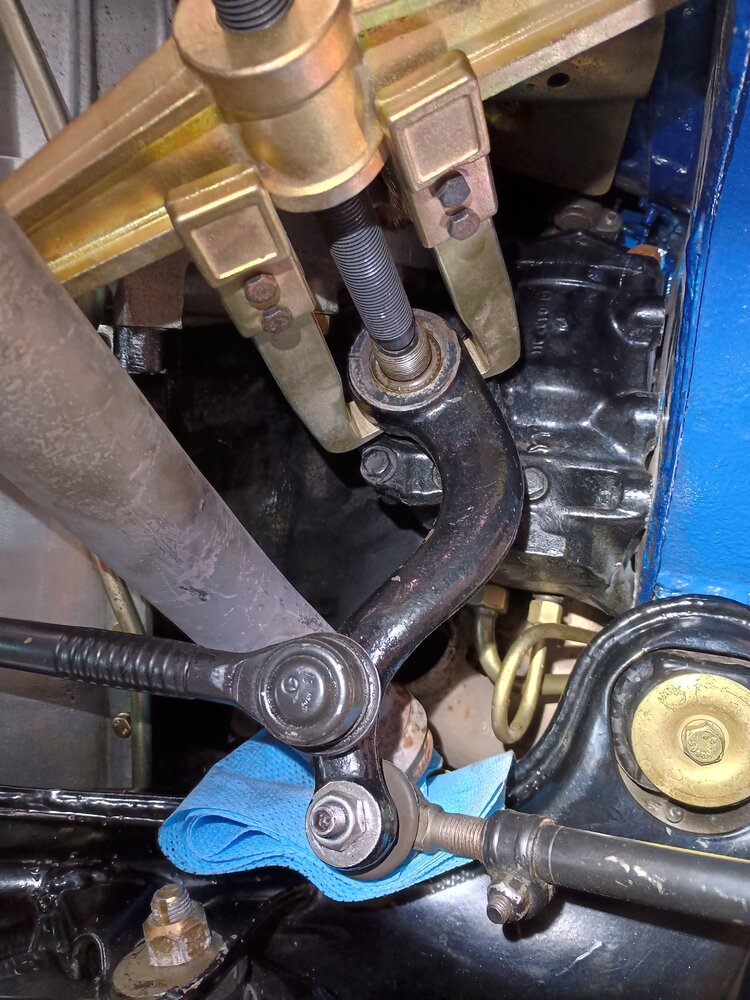

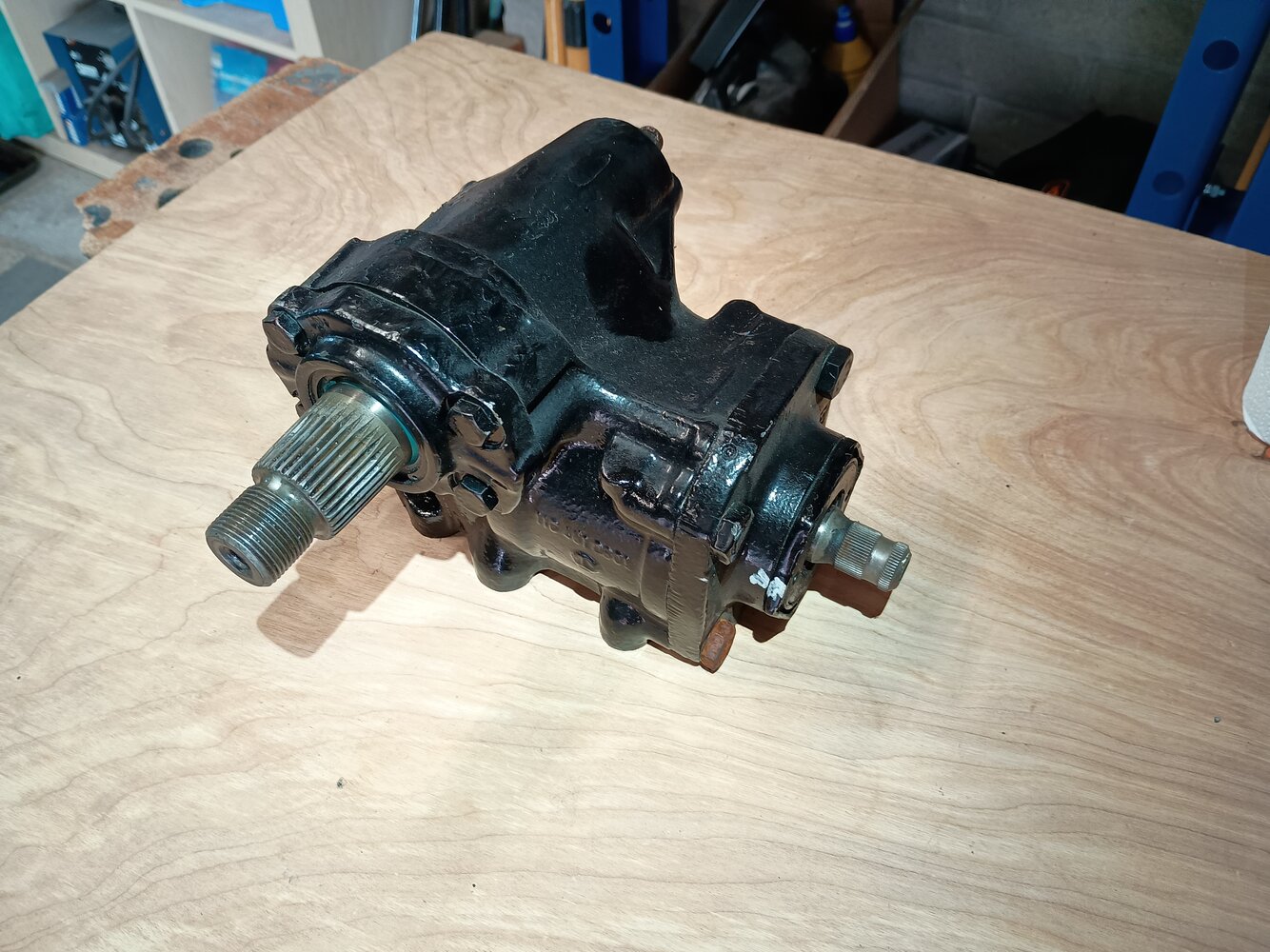

I took the merc out for a drive today, its not been driven or moved for 5 months, the steering was working just fine when I put it away but not now.
The problem only happens on a right turn (vibration and hum), when the steering is loaded up. No problem with the car jacked up and the wheels up in the air till the right hand end stop.

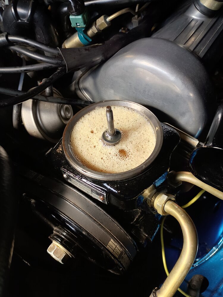

Checked the belts, tight, no slip.
Fluid level, at full level.
Felt for vibration on the pump, nothing, silky smooth.
Looked for the source of the sound, its coming from the steering box.
I can feel the vibration through the steering wheel.
Any thoughts, (a new box is £1200)?
