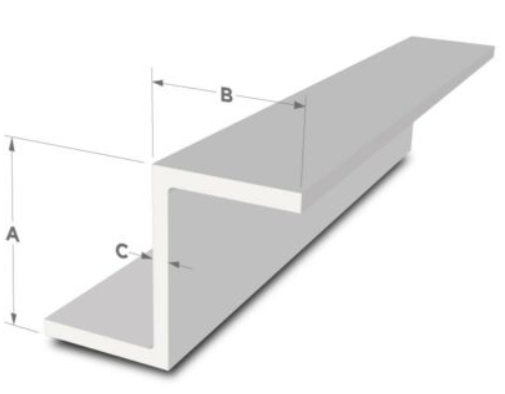

MattH Member Messages 4,515 Location Cornwall Jun 23, 2021 #1 I'm after some Z profile for rack supports in my Powder coat oven build. I can find plenty in Aluminium but I'm struggling to find a steel version. Does anybody know of a source?

gaz1 Member Messages 20,422 Location westyorkshire Jun 23, 2021 #2 id just use 2" angle iron and weld them together but id rather use u channel version to a degree fit with poles or bars you could use it as a shelf or as a hook unit instead with the poles being internal in the design

A Agroshield Member Messages 6,261 Jun 23, 2021 #4 I do not think the shape you show is made in steel, as the tips would buckle. Z-purlins are available in steel but they have an extra fold top and bottom. E.g. https://albionsections.co.uk/zed-section/

C CompoSimmonite Member Messages 6,031 Location Werrington, Staffordshire Moorlands. Jun 23, 2021 #5 Small I beam and cut off the sides ?
Tigman Forum Supporter Messages 3,895 Location Watford UK Jun 23, 2021 #6 Roofing suppliers , might be a tad large though
