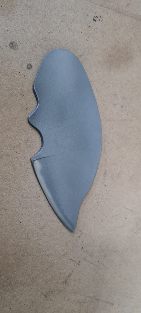

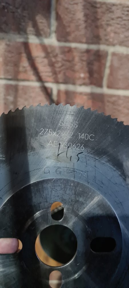

One of the cold saw blades shattered the other day, they do every now and again. I obviously grabbed the bits for knife making I've tried everything I know to soften the steel a bit, but can't get it below 75rc and drills won't touch it. Is this steel just silly hard and I'm not going to get it any softer or is there something else I can try. I've tried heats from blood red to sparking white each time burying it on hot sand to slow the cooling. The pics are a chunk of the blade and a leather cutter I ground out of smaller chunk @TechnicAl
