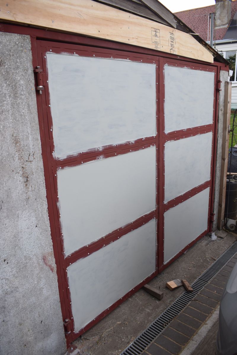

I have a project coming up and need to build some steel framed garage doors which will be clad and insulated. Each door needs to span ~ 2.4m (i.e 4.8m total) and I may opt to go with four bi-fold 1.2 segments instead. They will be hinged either side of the 4.8m opening from a Universal steel column (RSJ).
Currently my plan is to build a framework out of angle, probably 40x40 or 50x50 to give some space for insulation, with a diagonal cross brace and then weld on barrel hinges once everything is trued up.
I’m a little concerned with the amount of potential sag across this span – has anybody done anything similar and can comment on the suitability and thickness of angle for this, or any other suggestions or consideration?
I want to make them strong enough, but not so heavy they disappear through the earth’s crust.
