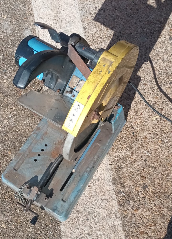

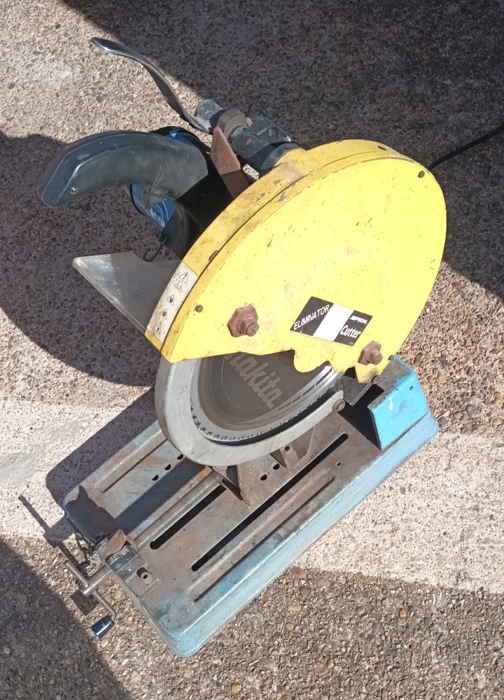

if your feeling ripped off , Ill give you 15 for it ,,,, so there ,,Paid a tenner for it, think I've been ripped off, bought it faulty, kept tripping the mains, cleaned up, repaired, well woth the tenner
I already had the blade new in packaging which was quite fortunate, the blade was also freethe blade alone is a £100....good for u.....
I wouldn't rip you off aswellif your feeling ripped off , Ill give you 15 for it ,,,, so there ,,
your winning .
I thought maybe a winding on the armature or a segment on the commutator had gone bad because it didn't always tripp on every start up but upon stripping it I found that one strand of the windings on both the armature and field coils were no longer bonded to the rest and were sticking out so pushed them back into place and stuck back down with the rest, measured all the coils on the armature and they all measured the same, same for both field coils, tested all wiring and capacitor which were also fine, so give a good clean internally reassembled it and it's working perfectly.why was it tripping the mains ?
