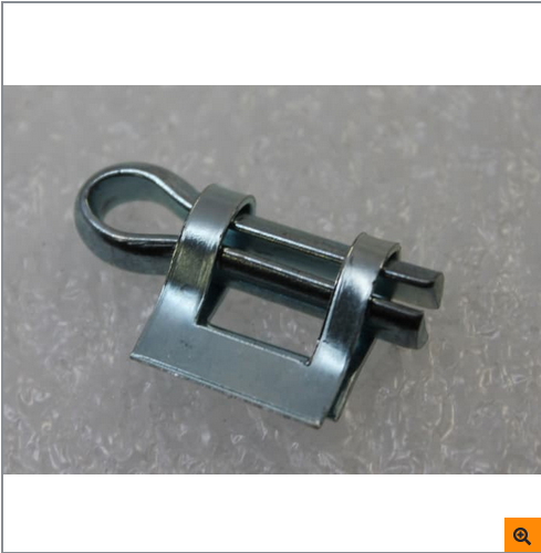

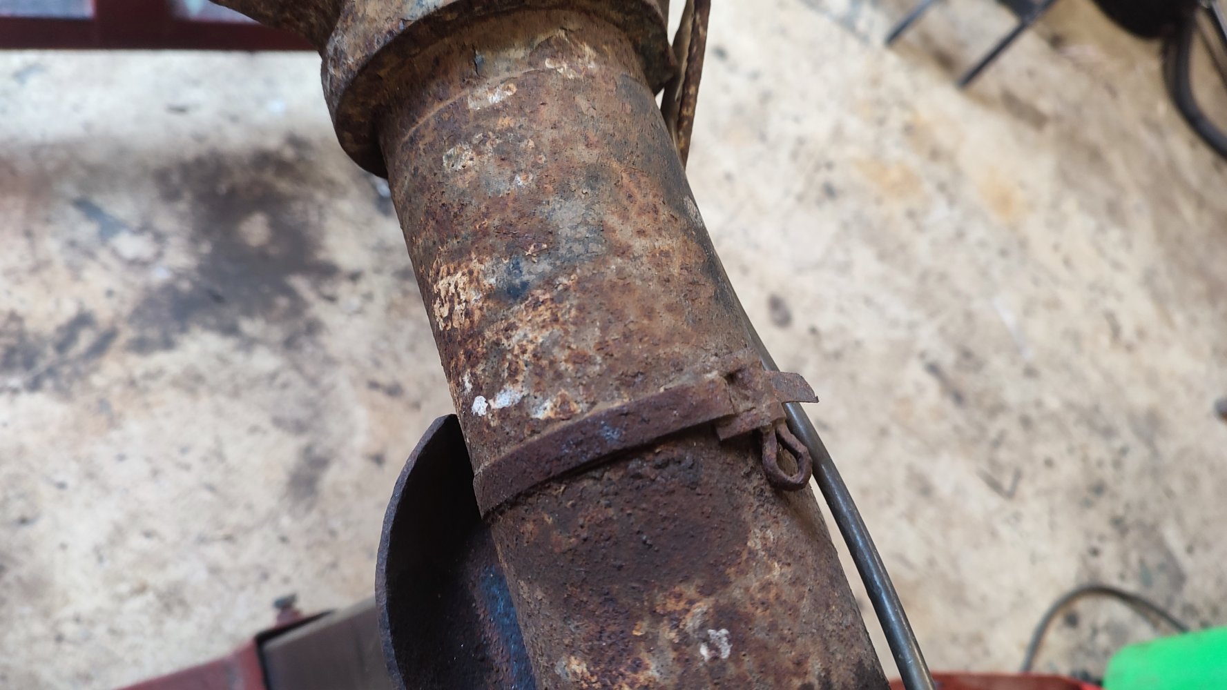

CV joint stainless boot ties might be an option....they're reasonably cheap but aren't exactly the same as your picture though.
What do they hold on?
I know you probably want them the same but look at stainless steel zip ties.
I think if I was to use something else I'd just go with UV rated plastic cable ties, keep it simple!They use them for lagging on hot systems, or something similar anyway. Just a smooth metal cable tie which secures by a tiny ball bearing rolling into a wedge gap.
This is the bit you need, the band is the easy bit. You could probably make one using a chunky split pin.
Mercedes Hose Clamp Key Stoddard 999 512 122 02 SIC 99951212202SIC 999.512.122.02.SIC | Pelican Parts
Stoddard Hose Clamp Key Call (310)626-8765. May Qualify For FREE SHIPPING. Parts# 999 512 122 02 SIC 999.512.122.02.SIC 99951212202SIC. Sprinter, ML400, GLA45, E450, AMG, 928, 924, 3500, 2500.www.pelicanparts.com

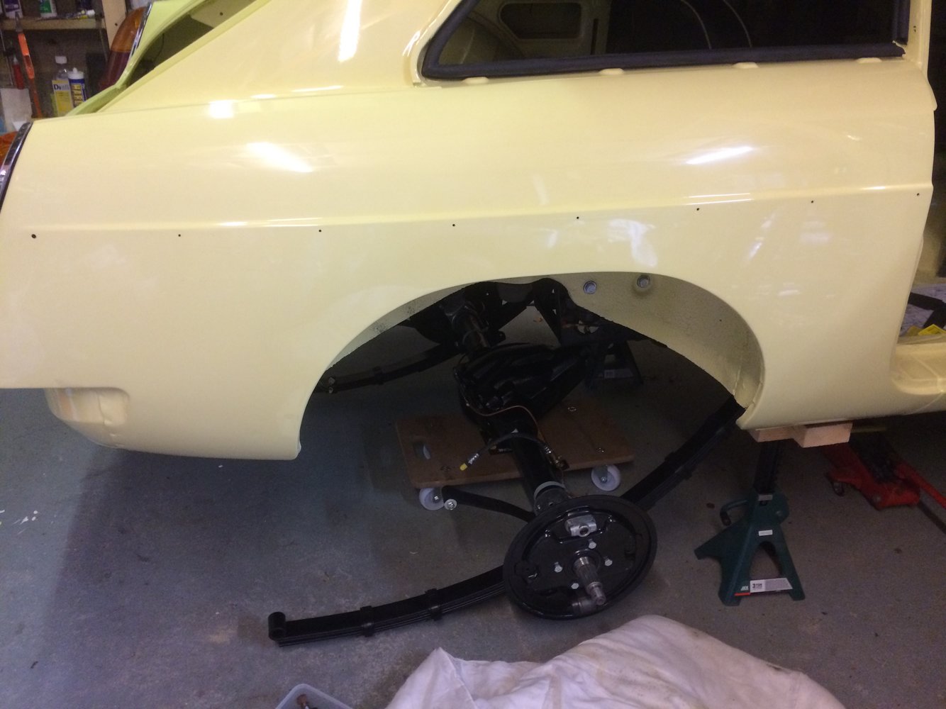

Thank you both! I think I'll be able to get this sorted now. Thanks again.They were an original fitment on MGB rear axles. Any of the usual suppliers (MGB Hive, Moss etc) should carry them.
As fitted to my GT:
Close up:

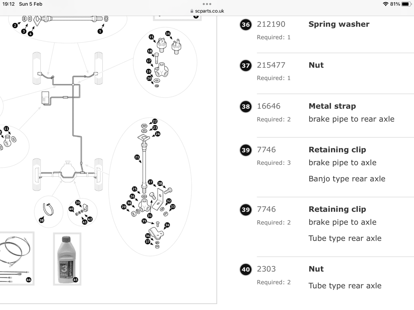

Extract from the SC Parts catalogue:
