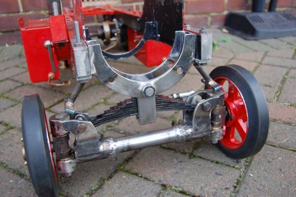

My father-in-law and I are in the middle of restoring/modifying a 1/5th scale steam lorry. The modification has involved some pretty drastic surgery to the front end i.e swapping the cart spring solid front axle for a Foden style transverse suspension front end. The only power tools we've used so far are the stick welder, drill press, angle grinder and £20 Lidl belt sander (linisher). Materials have been donated by the scrap bin.
Build progress will be updated here
