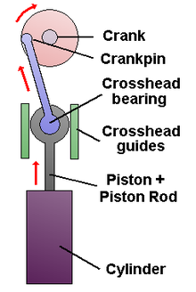

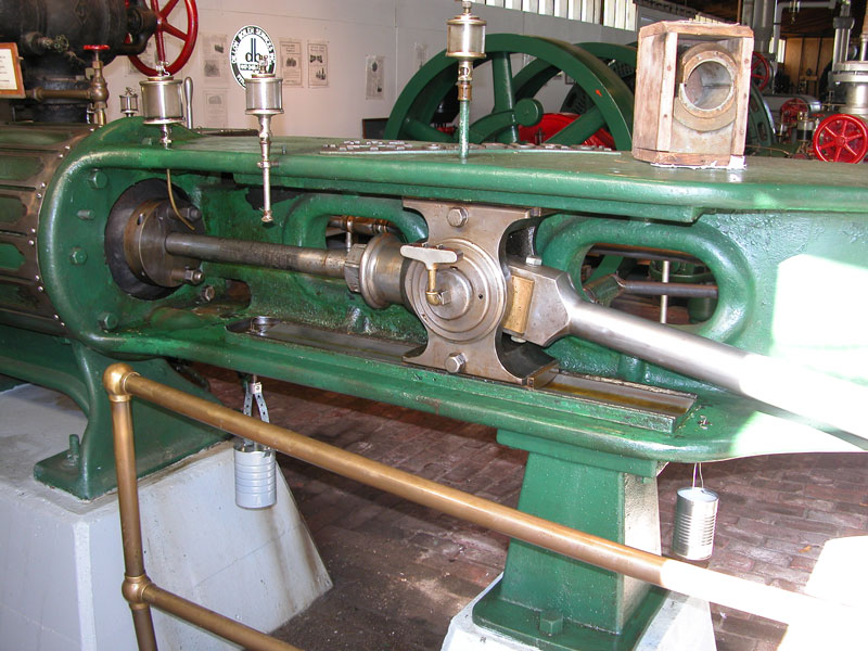

Miranda Member Messages 390 Location U.K. cornwall May 31, 2021 #42 If it’s a traction engine or something similar, then most of us drive them on the regulator which means that anytime there is engine braking going on as opposed to drive, then the load will be switched to the other side.
