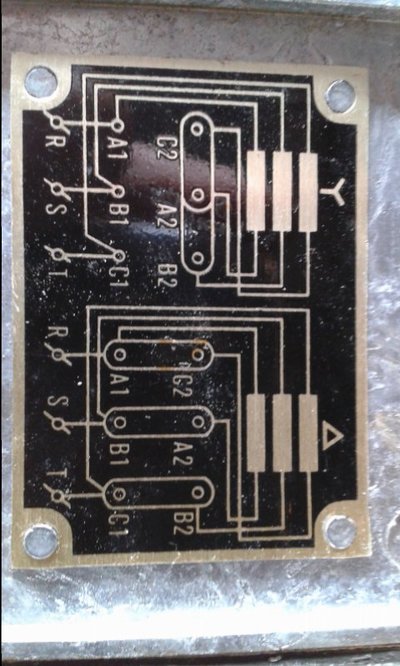

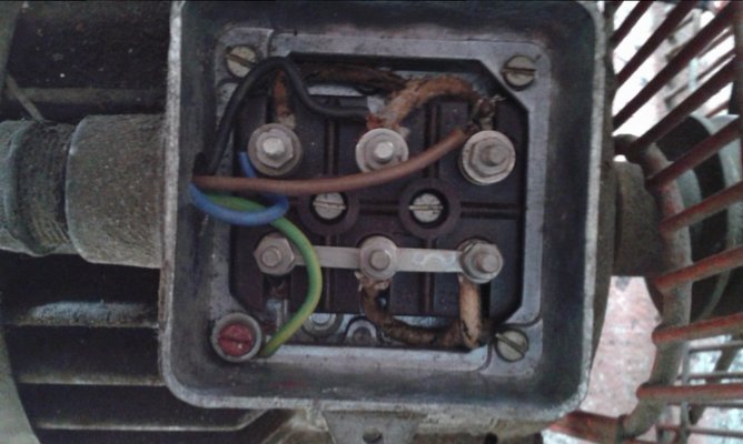

mr migwire It's more fun with metal. Messages 1,873 Location fife Mar 29, 2015 #1 ok guys so I got my ajax saw delivered today and I already have an invertor set up in the workshop, the motor on the saw is 220 / 440 so will run from the invertor but what way do I wire the motor for 220 3 phase? 20150329_165238.jpg 89 KB · Views: 80 20150329_165250.jpg 84 KB · Views: 55

Spark plug Member Messages 4,036 Location Durham, England Mar 29, 2015 #2 The motor is currently wired for star (415v) To wire it delta move the jumper plates so it's wired like the lower diagram in your pic.

roofman Purveyor of fine English buckets and mops Messages 12,987 Location North West with water on 3 sides Mar 29, 2015 #3 put the links across the terminals as shown in the lower pic..DELTA. and any 3 wires to any terminals iirc mate with earth to the chassis.

H hareng Member Messages 1,488 Location Wolverhampton Mar 29, 2015 #5 I wrong direction change any of the three wires over. My inverter will run that in Delta.
mr migwire It's more fun with metal. Messages 1,873 Location fife Mar 29, 2015 #6 done and running like a machine should ....
