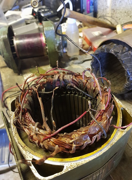

I've taken the 415V motor from my mill apart so I can run it off my 230V inverter
I found all the connections between poles, and the star point (lower right) and multimetered everything to find each pole is about 1.5Ω and 6Ω from any of the supply lines to the star point with no weird cross connections so I'm happy its a functional motor.

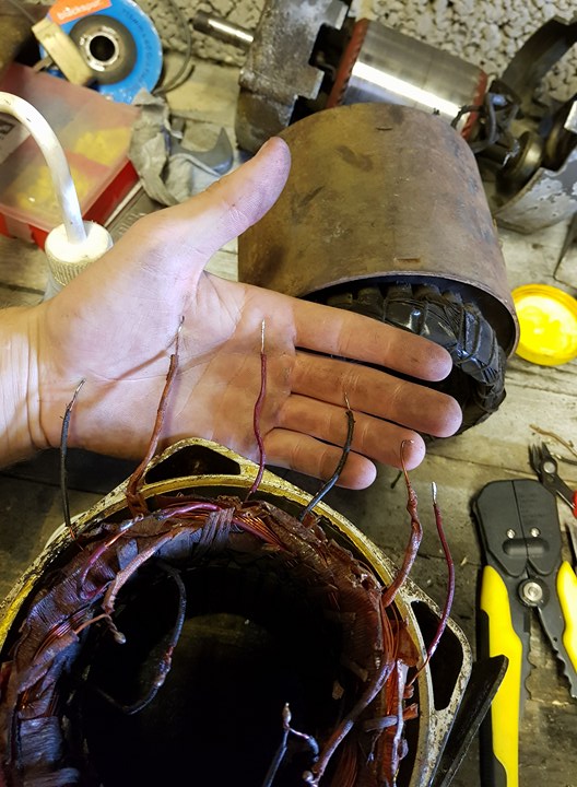

I cut the star point and got all 6 ends of the required connections tinned, then went in for lunch. Now I can't remember which wires came from the supply and which from the star. Is there a way I can test which is which?
