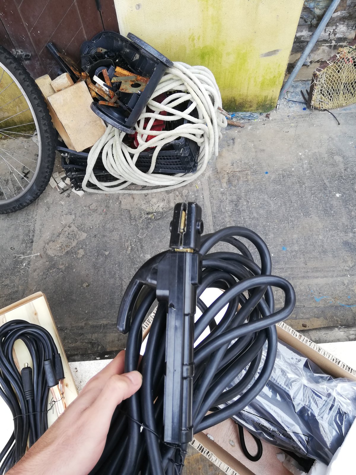

Finally i bought my first inverter stick welder
ItsI a Stamos s-mma 250 igbt , basically a simple DC stick welder
Good packages very sturdy
Copper plated alluminium welding leads
8 meters long
Horrible ground clamp which is just burned out yesterday, i will replace it with a proper cast brass one
Not enough good electrode holder that needs to be hold closed by hand
Also this was known, and need to be replaced with a proper electrode holder
Now the welder is simply good , the arc seems clean without spikes and very easy to start also using 7018
When cracked off the fans runs yet until the welder cooling down
This afternoon some photos
