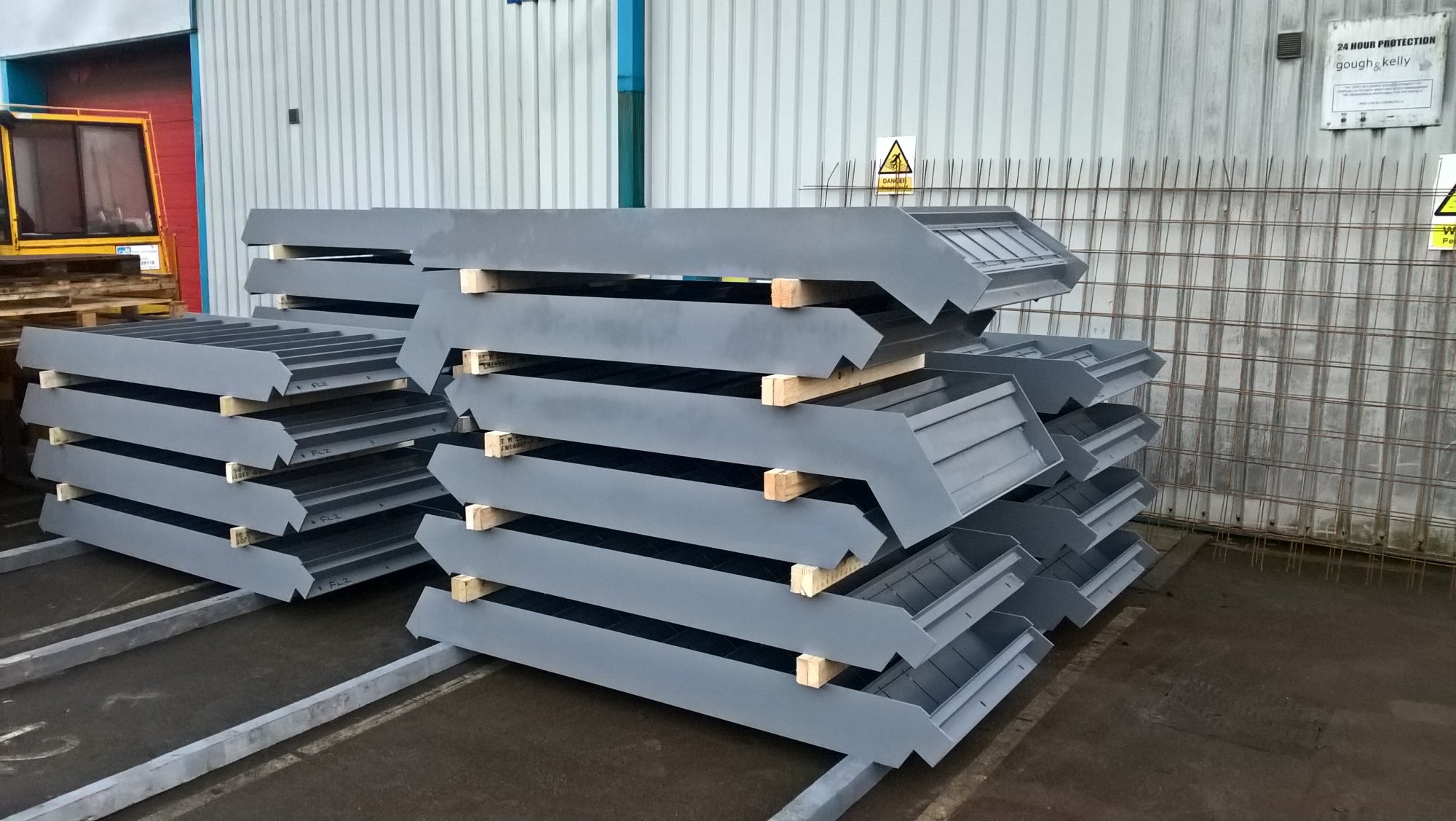

One if this week's jobs - A small batch of 20 staircases destined for a student accommodation job - A very regular supply-only job for us - we have a trade secret method of jigging these so it takes 2 men 25 minutes per stair to put together and tack up, a welder 30 minutes to weld and someone else 10 minutes to paint. Paint just drying nicely here in the afternoon wind
