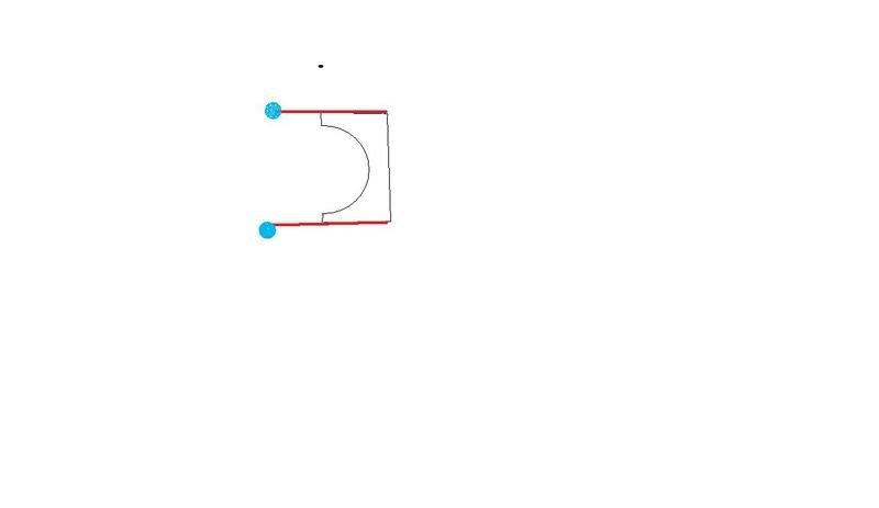

im making up some shock mounts for my 4wd but i have only got stainless. ive already made them up and ready to welded on. the moutns are 304 stainless because it was all i had onhand. question is for welding them on. will be welded inposition (vertical)
i was thinking of doing a mild steel 4012 2.5mm for the first pass vertical down. then using a 2.5 308 electrode going vertical up.
diff is 3mm thick and the mounts are 4mm. corrosion resistance isnt a problem because ill be spraying it with a cold gal coat then painting it black anyway. just needs to be strong
maybe even tiging it. time isnt an issue and gas isnt either.
