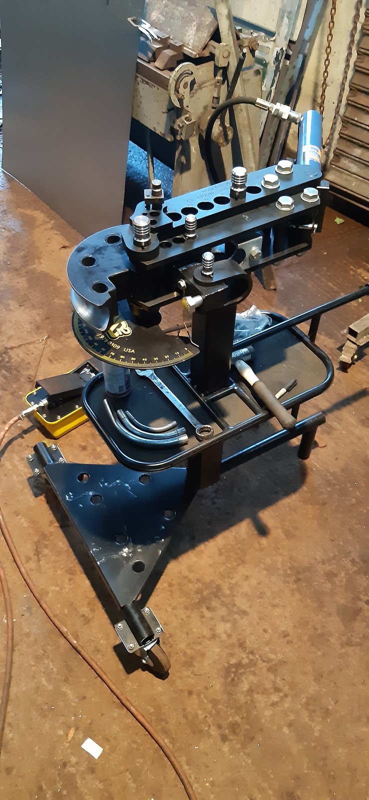

ghound Member Messages 316 Oct 6, 2020 #1 Would it be possible to have stainless pins machined for my bender and would they be suitable strength wise? Cheers Robert 20201006_175531.jpg 235.5 KB · Views: 82

Brad93 Member Messages 19,089 Location Essex, United Kingdom Oct 6, 2020 #4 ghound said: The standard pins have started to rust. Click to expand... Stainless is gonna be 3 times the cost and probably not as tough as a steel pin. Dunk them in citric acid

brightspark Member Messages 41,269 Location yarm stockton on tees Oct 6, 2020 #6 squirt them with wd 40 or a bit of diesel
mike os just a little insane..... Messages 9,809 Location North Wales Oct 6, 2020 #7 Stainless isnt that hard or tough, I wouldn't go there
Onoff In the land of the unfinished project I am King! Messages 12,757 Location Sevenoaks, UK Oct 6, 2020 #8 Keep your pins in an old ice cream tub with lid. Just give it a good squirt in there of WD etc.

grim_d Unlikeable idiot. Messages 4,275 Location Scotland - Ayrshire Oct 7, 2020 #11 Onoff said: Keep your pins in an old ice cream tub with lid. Just give it a good squirt in there of WD etc. Click to expand... The less messy option is to buy some VCI paper and line the tub with it. Works tremendously well.
