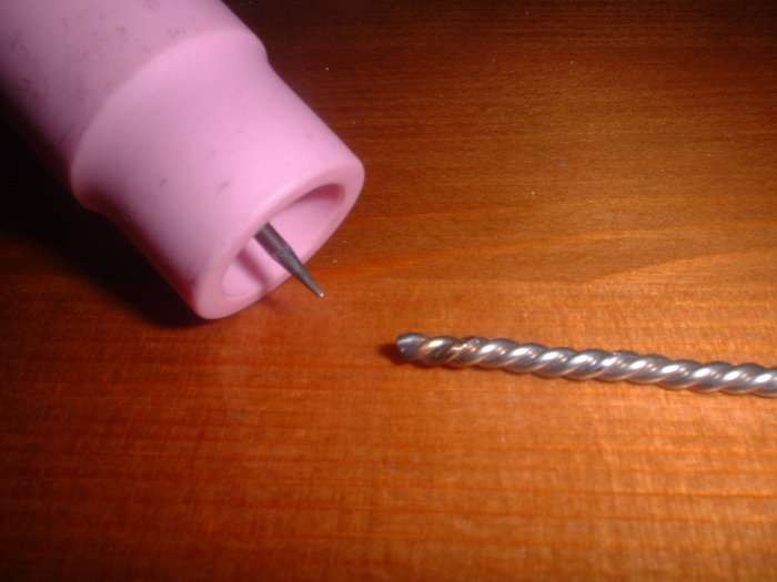

The only problem may be that being thinner you may struggle to feed it fast enough, it can also be a bit tricky to hold and feed, especially if wearing gloves, you can bulk it up by twisting 2 or 3 strands together using a cordless drill
I was educated on here to use the cordless drill and twist method, I usually pull of about 30 feet,double it and hold the cut ends in the vise, a hook in the drill chuck into the loop and away you go,keep a good tension on the wire while twisting.
