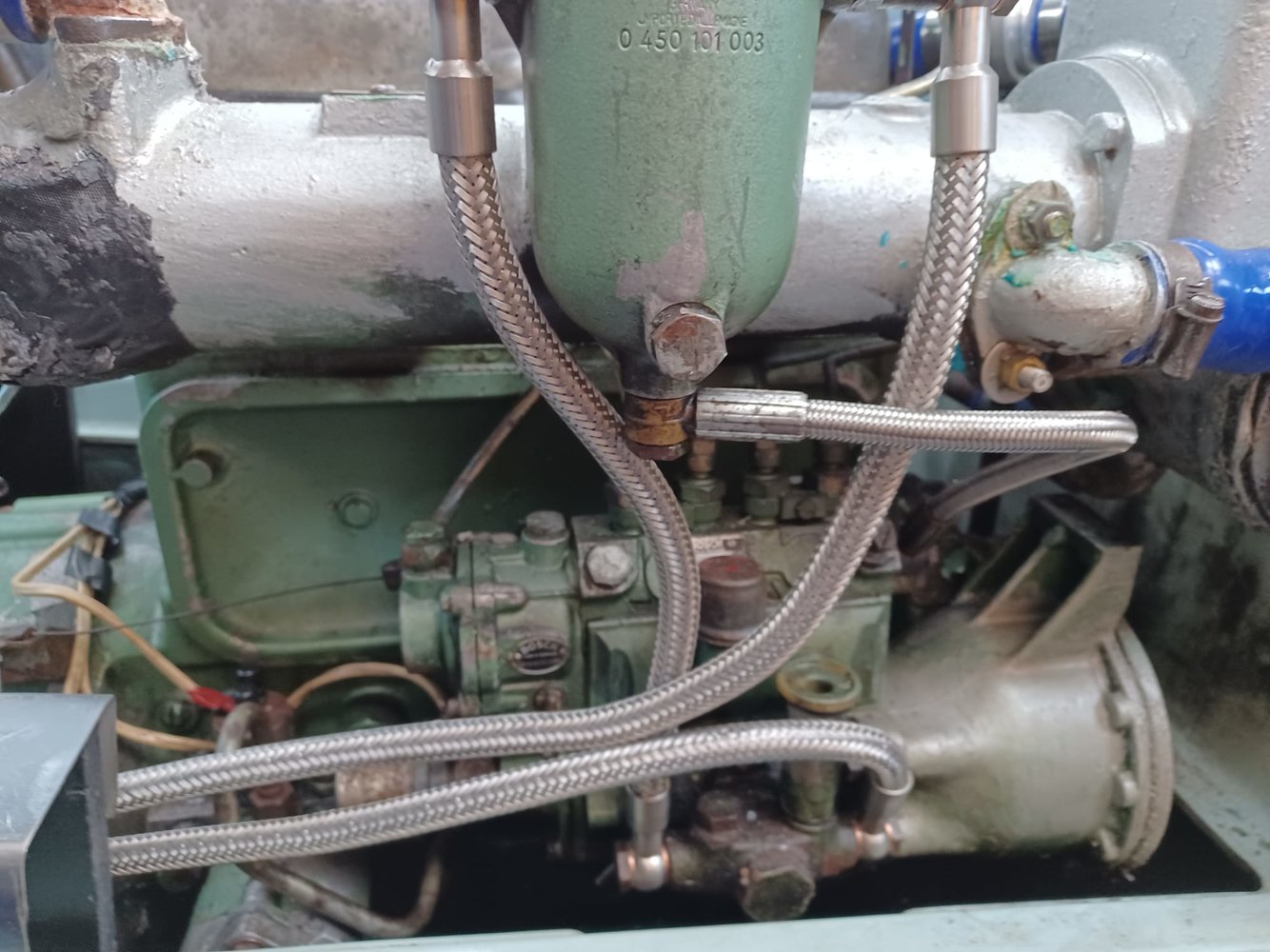

P pint Member Messages 264 Feb 15, 2022 #22 JoelC said: Hose, PTFE, Steel Braided, Assembled, 1/4 in., JIC-04 37 Degree Flare Fittings I'm not sure if the JIC-04 are the same as brake line couplings. Click to expand... Torques do reusable fittings, easy to make a hose up yourself. -3 is brake fittings. James1979 said: For your application why not plastic pipe and push fits. Keeps millions of trucks moving. Click to expand... The heat kills the pipe ime.
