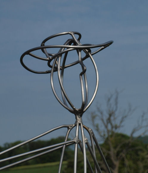

After much faffing about with gas mixes etc, I was happy with the results re spatter, I found the best thing is to control it rather than try to eradicate it, using heavt gauge foil to cover components, antispatter spray and arranging the components so that spater would fall away from them.

I put the price up for making him in stainless, but should have gone more as I forgot how much finishing and messing about there is using stainless. Still, a good result.

You've captured the trademark hat and the posture perfectly - great work
