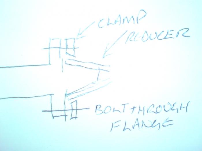

but there must be a better/ more accurate / safer way ?
if i mark it with a fine marker pen i would have a line to work too . obviously i dont want any gaps and to keep it square .
plus the inside of the tube is on the outside edge of the reducer so hard to hold straight whilst tacking

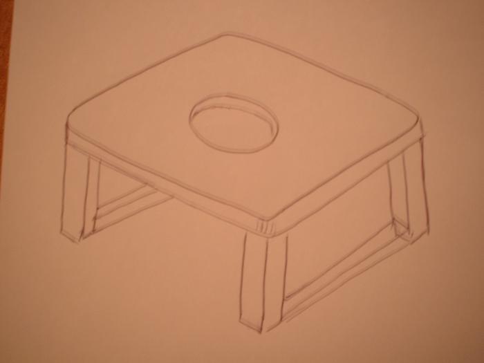

Could you not flare the end of the tube to just go over the fitting?
You know like you can gat a tool to make copper tube a bit bigger diameter to fit over the same size tube to avoid having to use fittings
That sounds good if you are doing a few and have a lathe you could make something along the lines of my pretty poor drawing.Ive got a small jig for doing exactly this, its basically a 6mm plate with a hole in it that the small end protrudes through, then use a flap disc to take the end off the reducer to be level with the plate, the plate has legs welded under to keep it square. useful on site, but in the workshop I tack the reducer to a bar and face off in the lathe.
Exactly right paul , dont want any crevises . dont want a little job facing off a few do you
Your jig idea sounds goodalthough a wee bit of work to make it .
