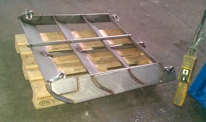

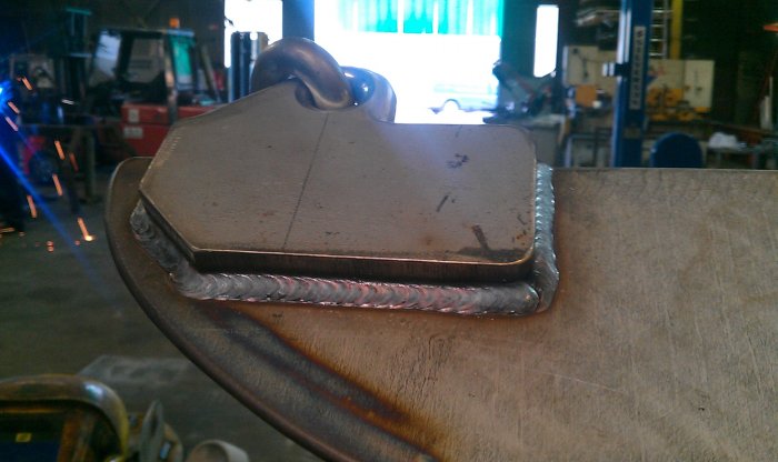

Couple of pictures of a nice little stainless job.
All in 316 stainless.
Chains from 20mm bar, rings from 25mm bar.
Couple of sets of chains, various sized links, and a ploughy thing they pull along in the sea.
Finished as far as I am concerned, but going for blasting, then to be load tested.
Chains Tig'd up, the 'plough' Mig'd.
It's a big ol' area to plow with something the same size as a euro pallet
