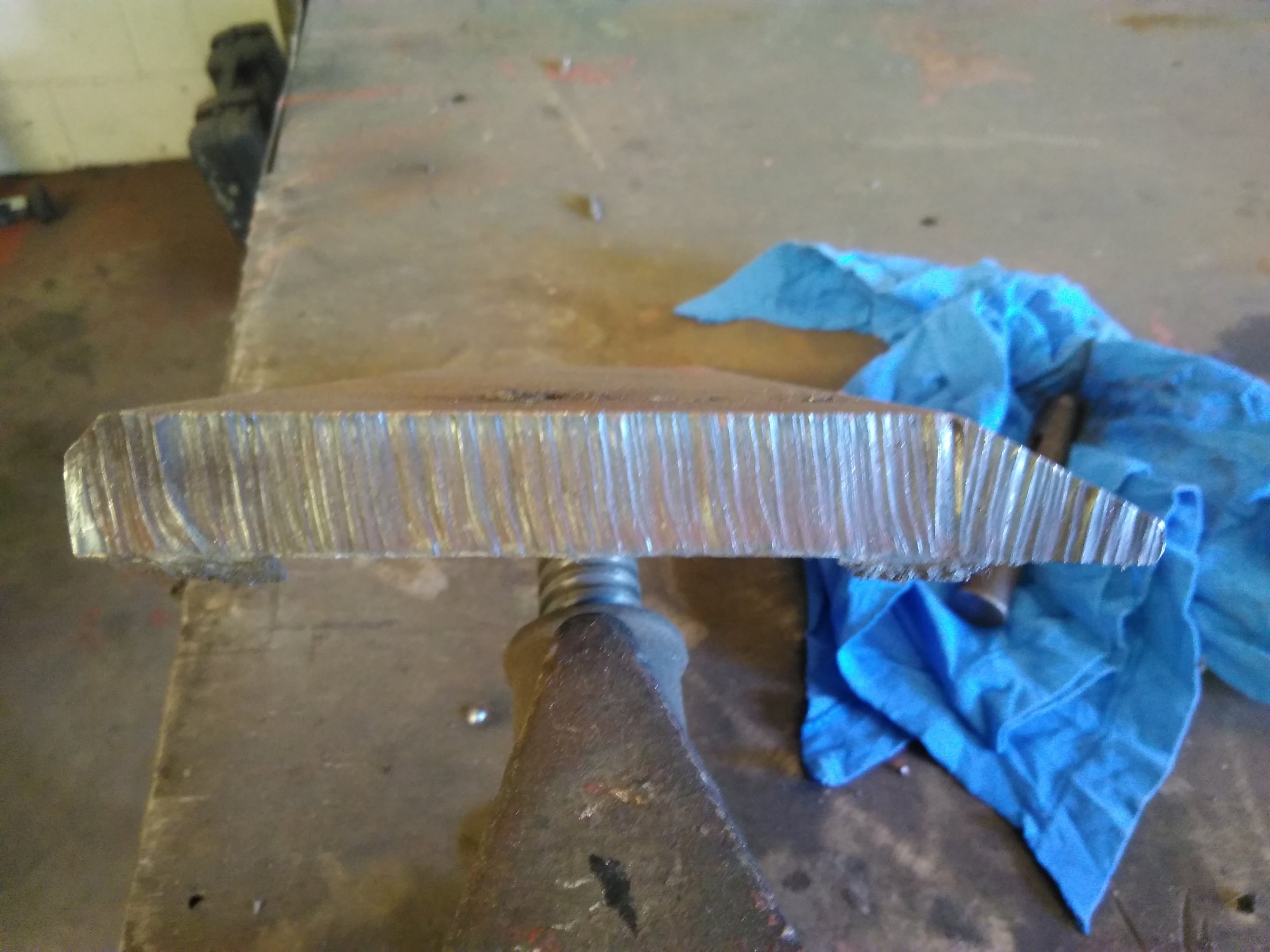

Someone would say that resting on the piece it's not good for the consumables and cutting quality .I always tend to use an adjustable square to run down (if it's straight edges I'm cutting) I have three I use just for plasma cutting . The arc gap is always consistent purely because I'm resting on the steel I'm cutting .
