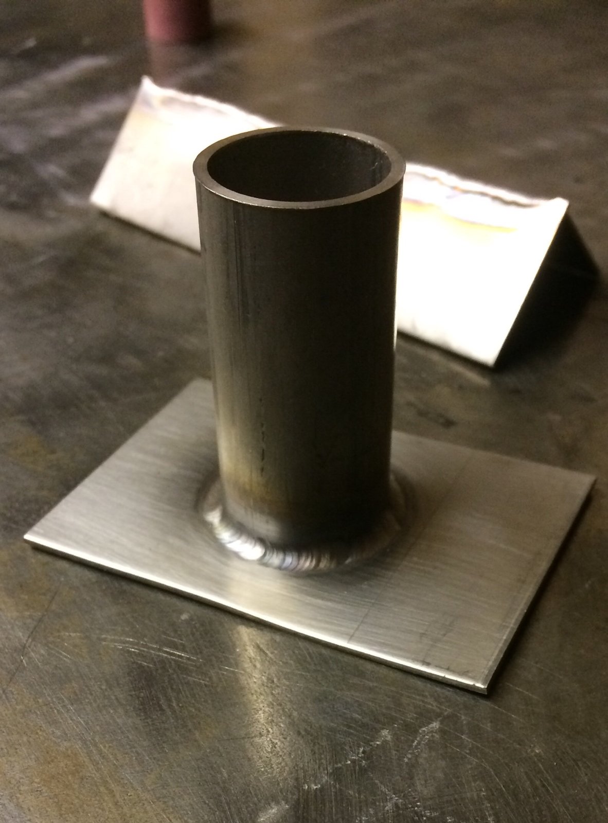

Was making a luvly job of tigging a piece of 3mm walled SS tube to a piece of 3mm SS flat sheet..
Ran min heat I could to get a puddle etc and ran the bead as fast as I could.. tacked first in 10 places around the tube and ran Tig beads in small runs before going opposite and running one there eg to move the heat around by not doing run in one go...
Flat sheet was clamped down on steel worktop but the sheet, not the tube, had warped all over the place...
Is there anymore I could do to overcome this pls... chill bars? Perhaps ...
Many thanks
