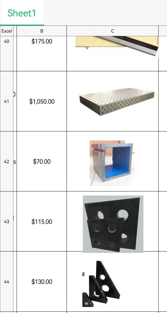

. I ordered granite and cast iron slabs, prisms, squares, squares, rulers, cubes, calibration polished cylinders for Morse taper 4, 5 and ISO30-40 and other little things.
