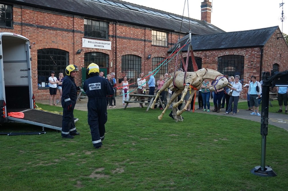

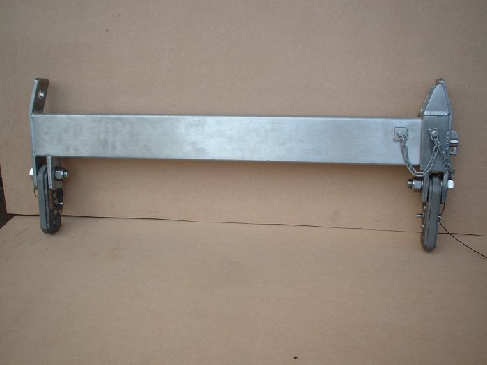

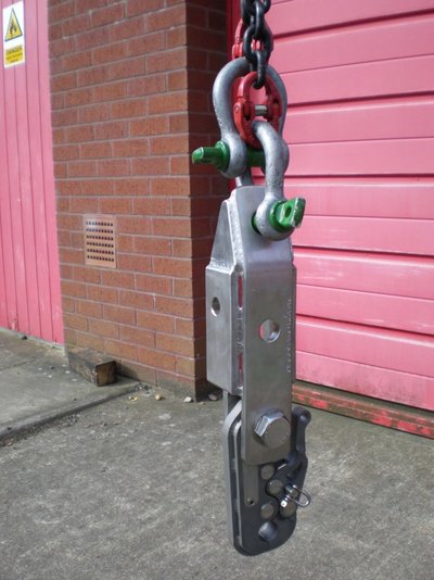

Another little job to share with you all, its a spreader beam with quick release fittings, used in the rescue of heavy animals, the quick release fittings work on an over centre principle like a toggle clamp, they are specially designed to release under load, the safety pin and release lever are pulled with a lanyard from a distance to prevent injury to the rescuers from excited animals.
I've been making these for a couple of years now, this is a variation, with a removable end, so it can be used as a conventional two strop lift, or the end can be used on its own with one strop
