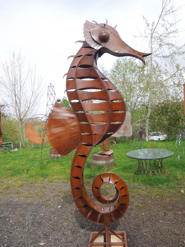

I have bought some yacht varnish for a sculpture i have just finished and would like to know if i can spray it on rather than use a paintbrush, There are no instructions on the tin about spraying.what thinners would be suitable ?
