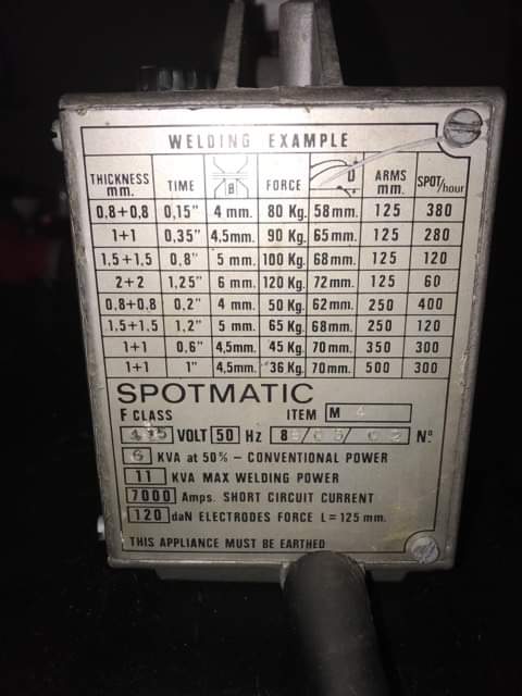

Presuming it is working off two of the phases i.e. Just 415 single phase, you just need a 240 to 415 volt transformer to run that.
I have the 240 volt version, and run it off a 20 amp socket.
