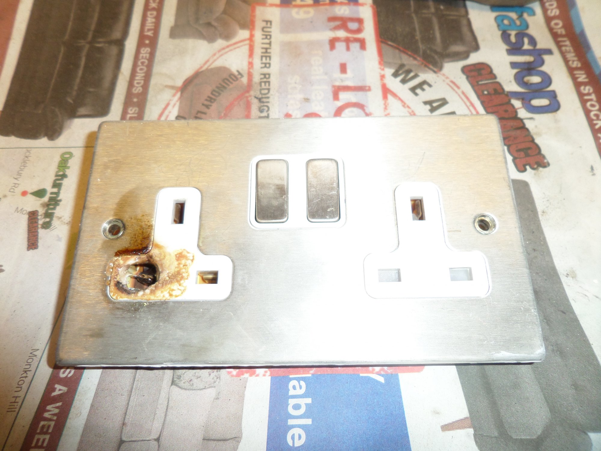

I was asked to a friends house this morning, for a coffee.
She asked "why when I plug my hover into the extension lead it trips the power?"
I looked. I am in shock.

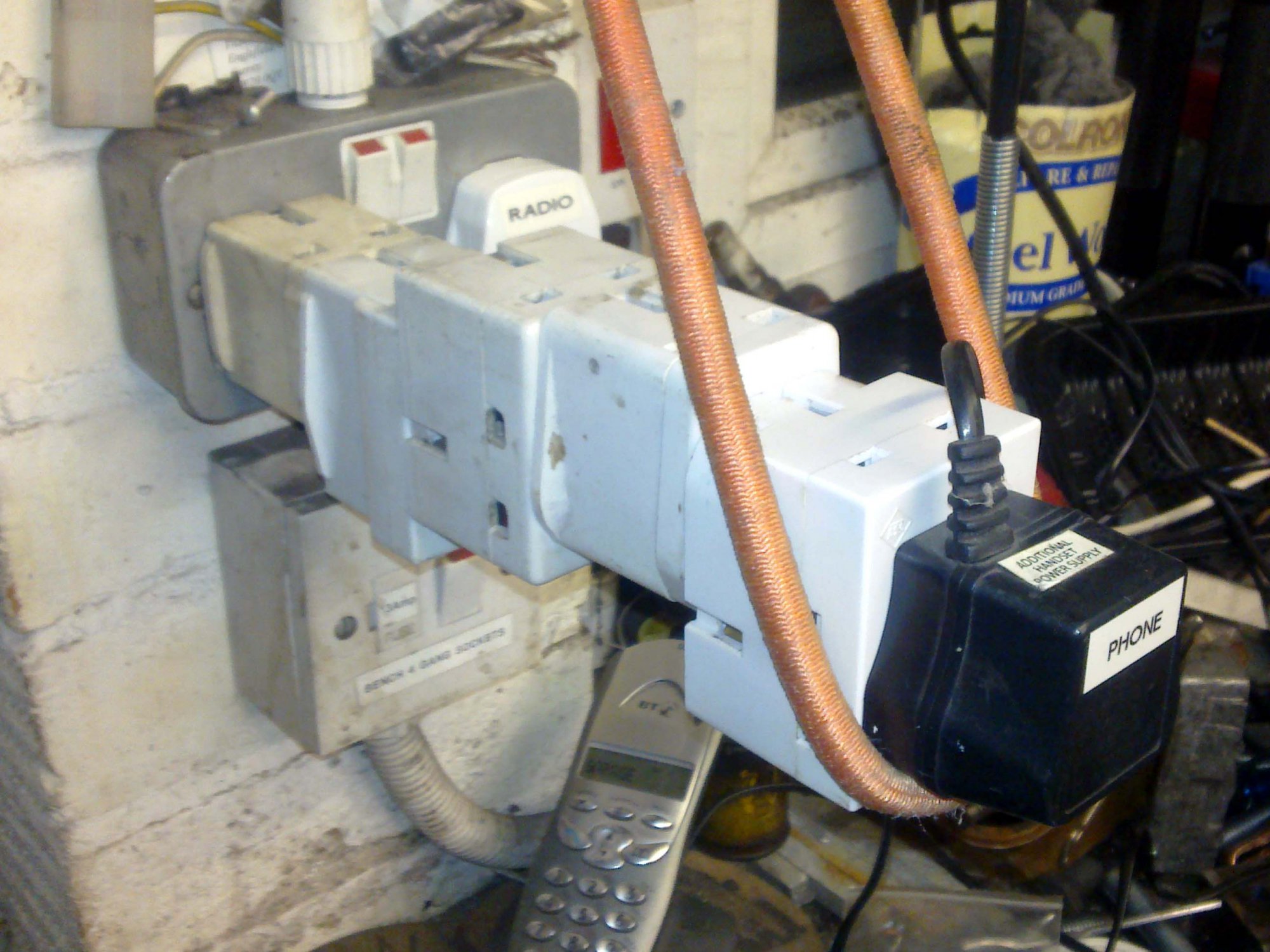

The extension lead was plugged into a multi-way plug adapter. There was a post on here a few weeks ago on why they are dangerous.
The double socket had in total 2 x 3 way adapters. All powering equipment and the extension lead what was for the Computer station.
In total 9 x 3 pin plugs, the 14th being spare for the hover.
This is what I found.
Yes, the 3 pin adapter is cooked, along with the wiring.
Lucky for my friend the sparky who wired the hose left enough to do a re make of the connections.
I have pointed her in the direction to get more sockets fitted and the breaker replaced.
