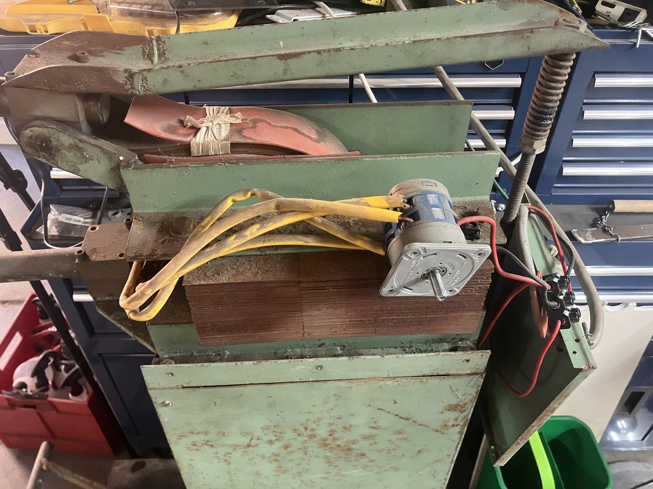

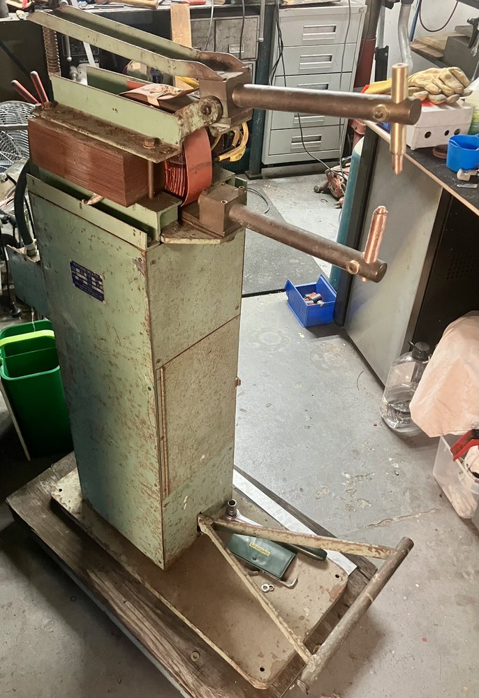

Hi all, I have a spot welder, pictured below with the covers off, but I can’t get it working.

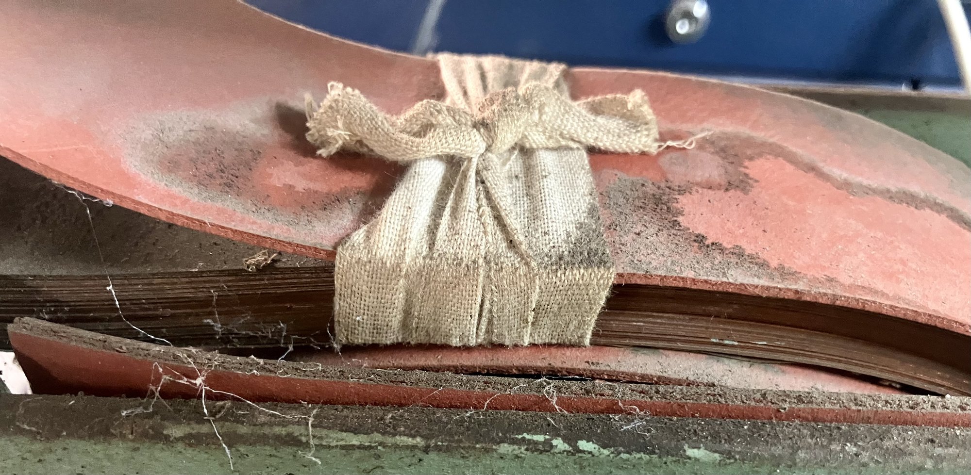

When I tread on the lower lever I can hear the transformer hum but no weld. I have cleaned EVERY contact between the power plug and the welding tips including the brass clamping blocks. It has three voltage settings selected by this switch…

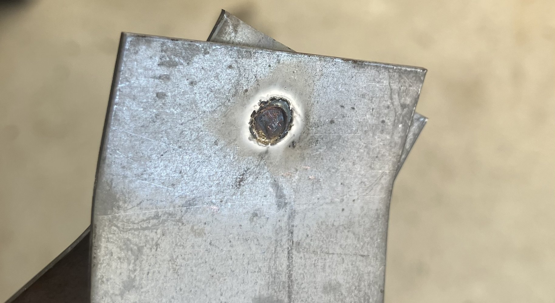

and testing the voltage at the tips shows 1 volt on low, 1.3 volts on medium and 1.7 volts on high but I don’t know if this is too low. I tested this by measuring the volts at the tips by engaging the transformer without the tips touching. The specs on the manufacture plate says 240 volt, single phase, 15 amp so it’s very desirable as most welders of this size are 3 phase which I don’t have. I also like the stand which puts it at waist height for me. The windings are made of multiple copper straps about 40-50mm wide.
To me my last option is to unwind the copper windings but I’m not sure what I’m looking for. After that I have a cheap Vevor spot welder I’m thinking of pulling the transformer out of to fit into this machine. While the Vevor machine works it has some shortcomings like 150mm arms which really limits reach. You need one hand to operate it making parts alignment awkward and the tips are just plain copper so they mushroom very quickly. Good quality tips are made of a copper/ chrome alloy to stop this. Yet another option is to use two microwave transformers. I’ve done this once before with a single transformer and it worked well as an experiment to melt screws etc but I didn’t make a welder. I guess if all else fails I could put it into a welder repair shop. Any ideas are welcome. Just as an aside, I paid $200 for this machine but was unable to test it as the seller (who I presume knew it didn’t work) didn’t have a 15 amp socket. These type of machines sell for around $2500 at the second hand machinery suppliers and around $5000 to buy new so I’m not complaining as I don’t have a lot of money in it, it’s the lies that makes me mad. Two main questions are, is the voltage high enough, and how can there be voltage without current. Thanks all, Stu. Australia.
