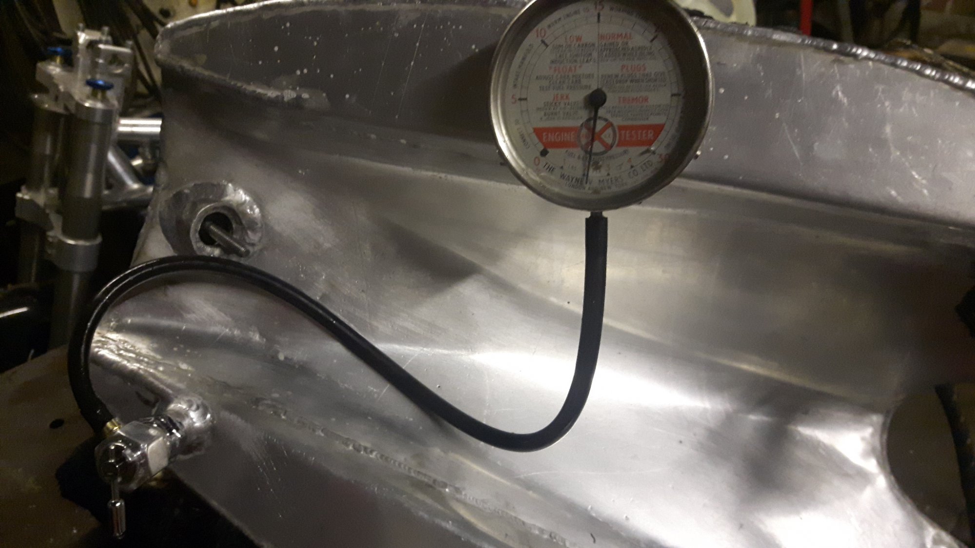

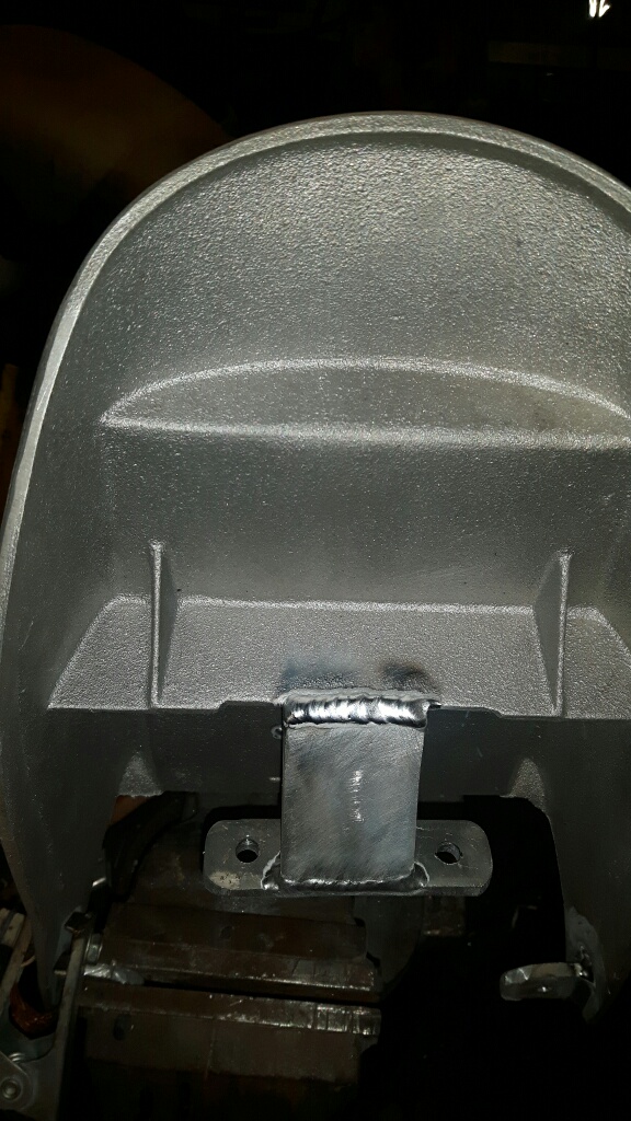

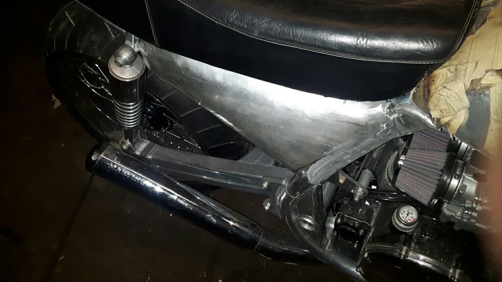

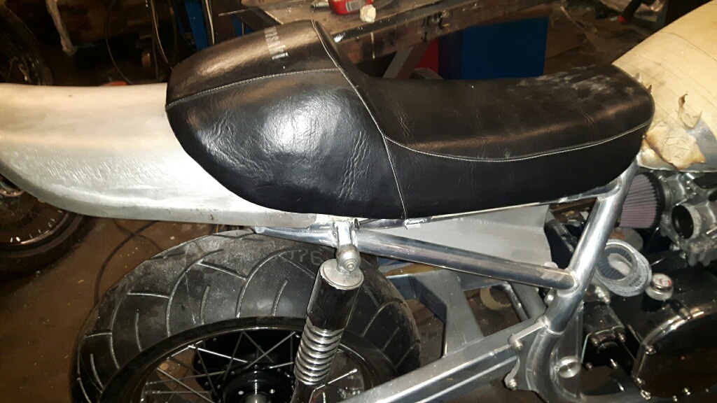

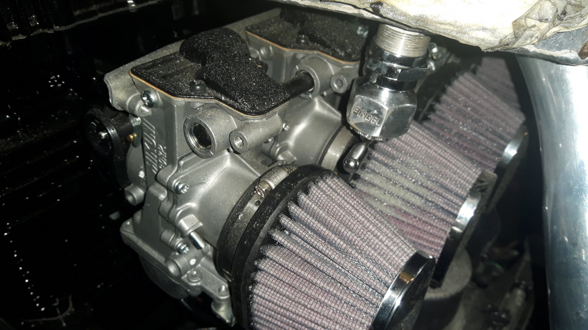

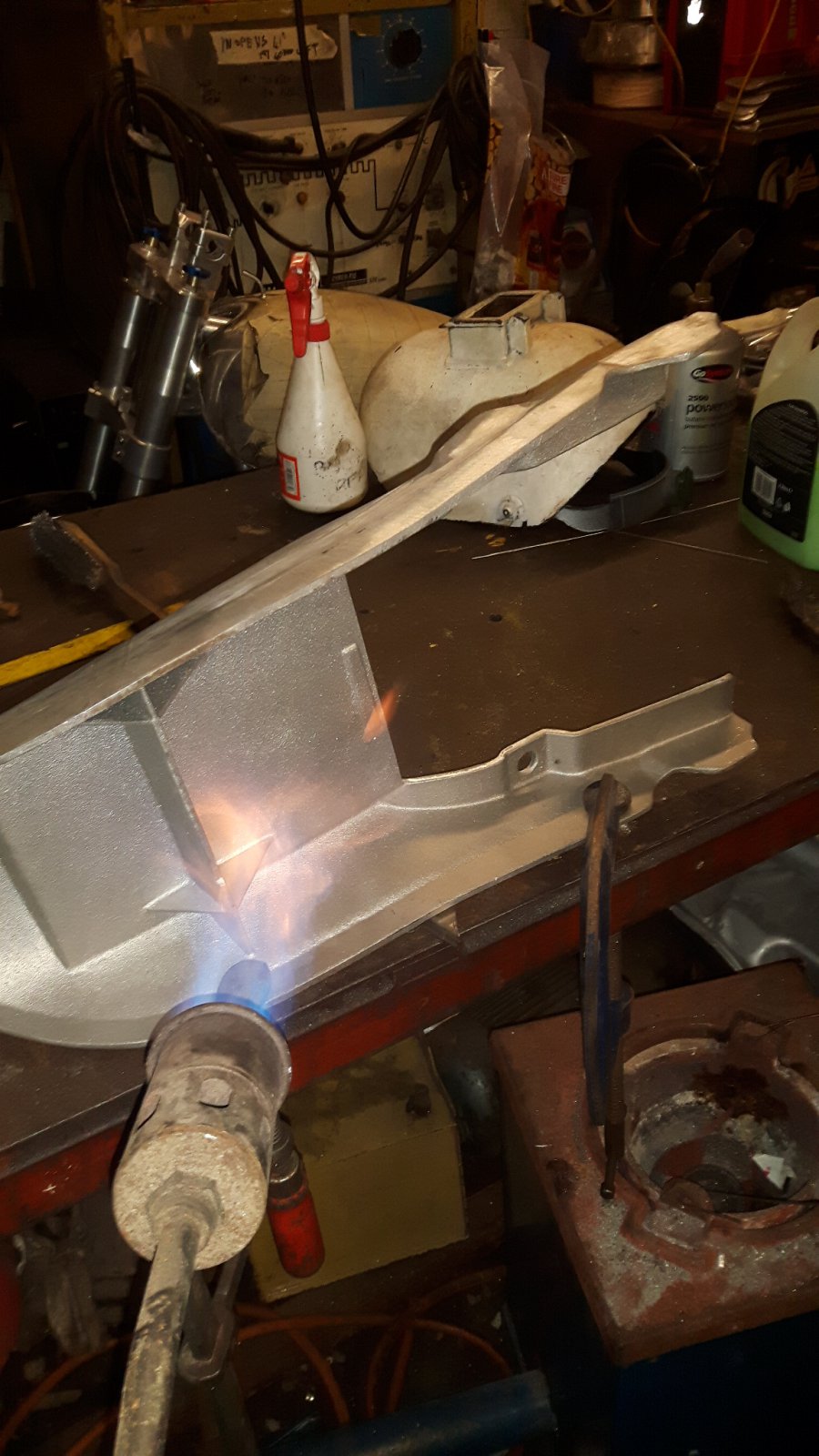

was doing a bit of modifying for a friend with a special alloy framed kawasaki that had a few owners who gave up on it the tank came from india did not fit and inside was truly shocking had to make a new bottom and mounts ,make side panels and reshape tail casting here im pressure testing tank ,castings can be moved by heating and applyi a bit of pressure next knocked up some side panels on english wheel being painted so not too fussy about lines etc should be a flier been tuned by some dutch guy look at the carbs top end stuff
