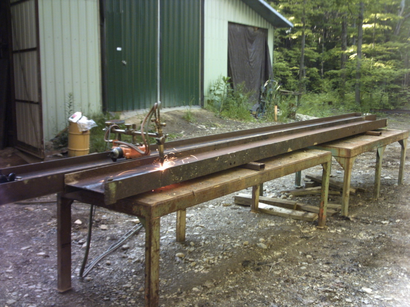

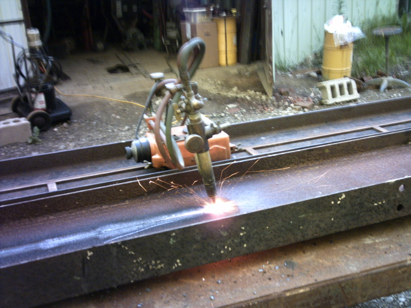

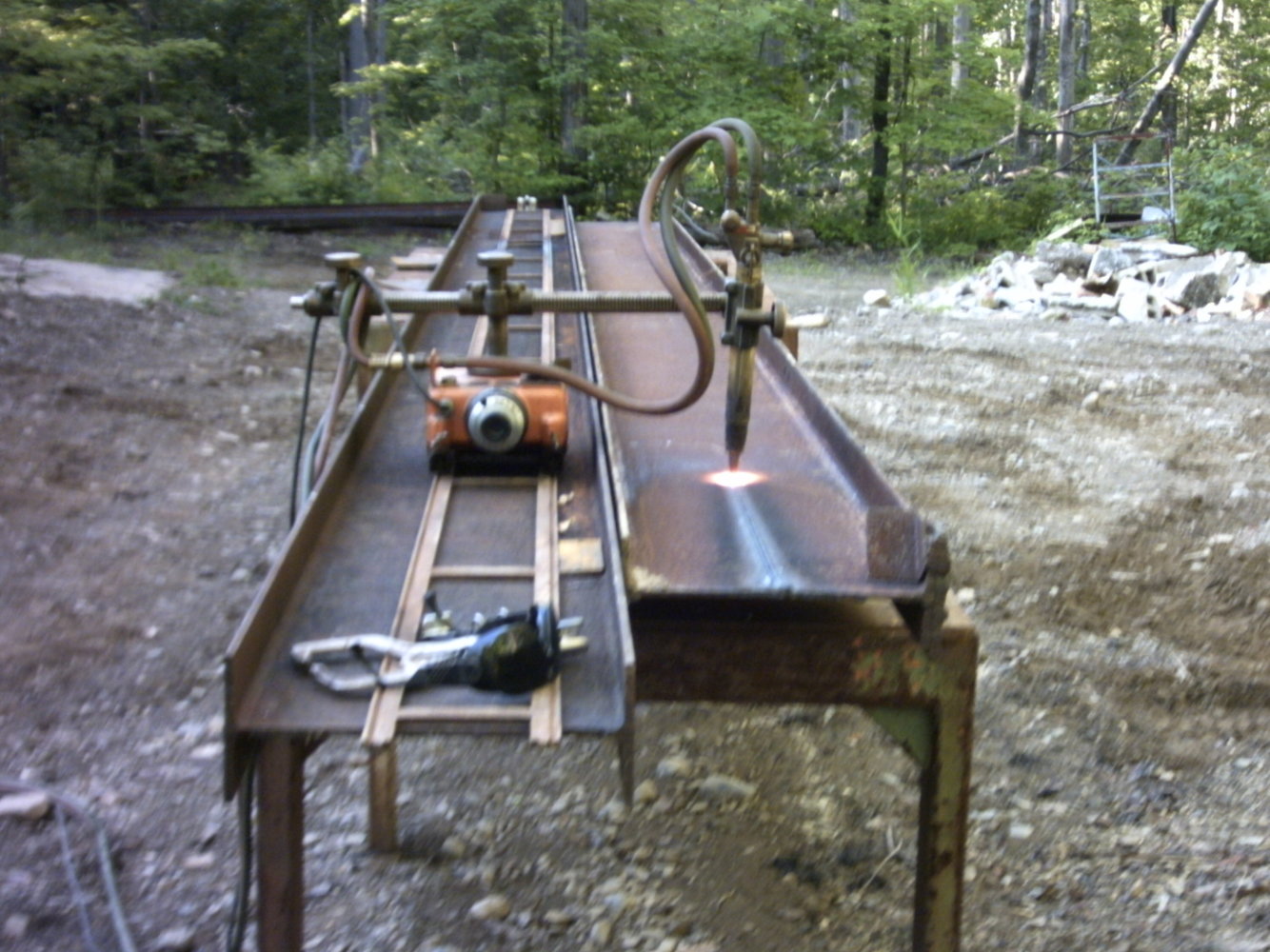

Temp. set up I made to put my track burner on and split some beams IIRC 15' long.
First one I did warped badly, second one I did not start at the end, rather stepped 1/2" in, and this held
pieces together until done, simple hand torch work to cut last little tab off.
IIRC I did qty (10) and they were light gage 12" WF beams. Hence angling the torch "forward".
