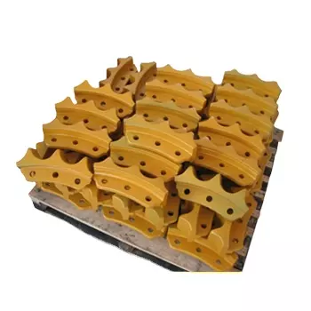

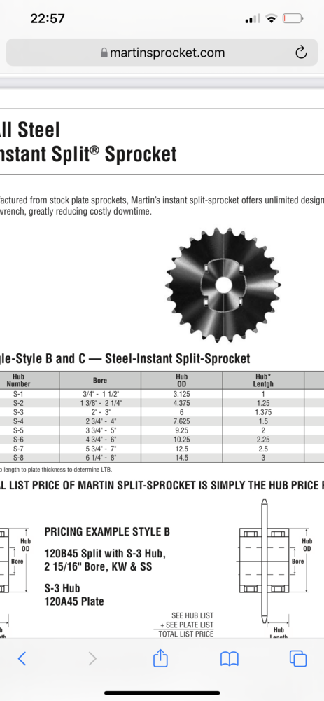

I need to make some large split sprockets.
So i can either buy platewheels or pilot bore sprockets. Either ways during cutting in half material is lost and the trough radius would not be right, if pilot bore the bore then isn't round and undersized.
How is this done in practice? Two platewheels to make one seems like a waste.
I need split sprockets with bores from 125mm up to 215mm.
Or one big sprocket with 215mm bore and then split inserts to bring the size down.
Again split inserts. Do you split a ring, bolt back together then finish machine the bore?
