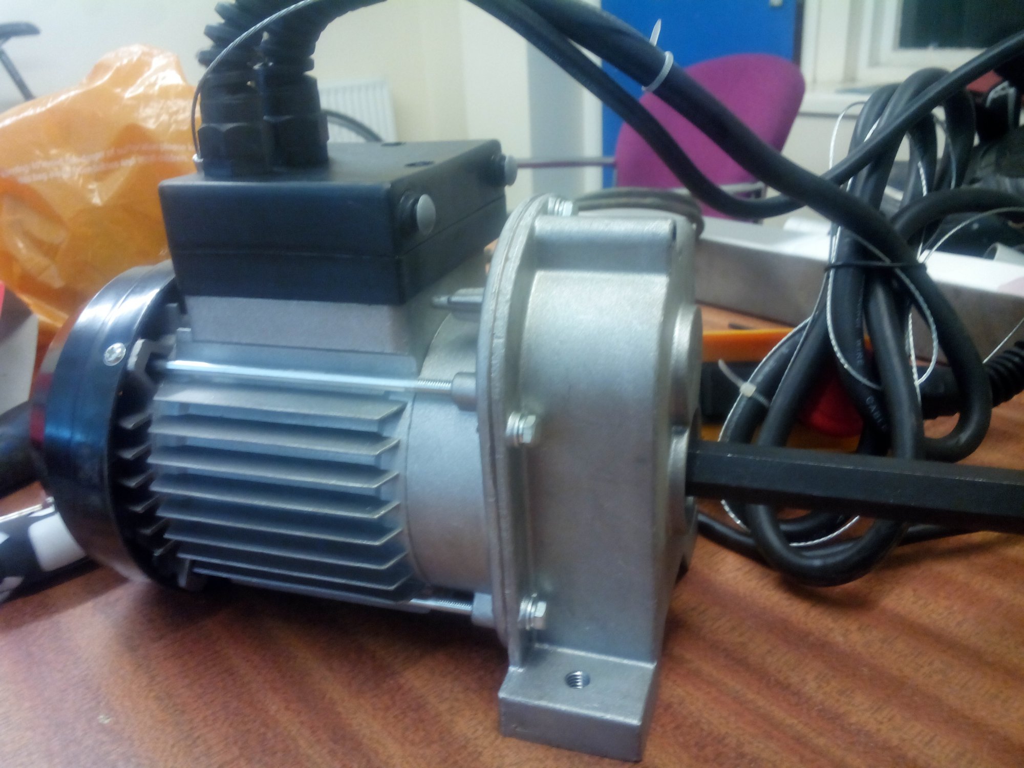

That sort of reduction would have the motor running at around 5 hz - I would have thought that on a single phase motor your going to have very little torque in that region, added to the fact the cooling fan may not work properly (it won't flow enough air to cool the motor) when run for prolonged periods at that speed.
Yeah - I would guess that's outside a sensible speed range.
