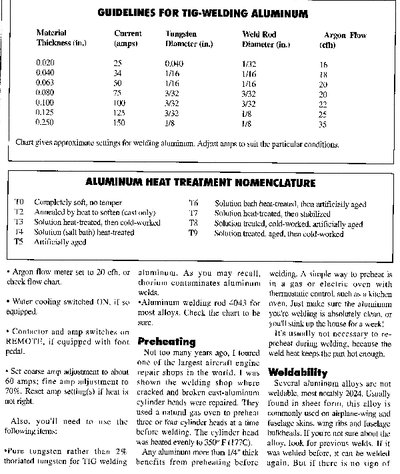

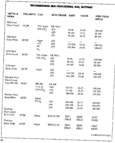

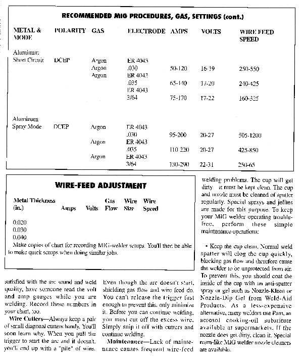

Just got a book out of the library today. I'm cramming as my welder gets here Thursday. I will try and upload the spec page in a jpg. Two are on mig and one is on tig. They may look blurry but will print out fine.

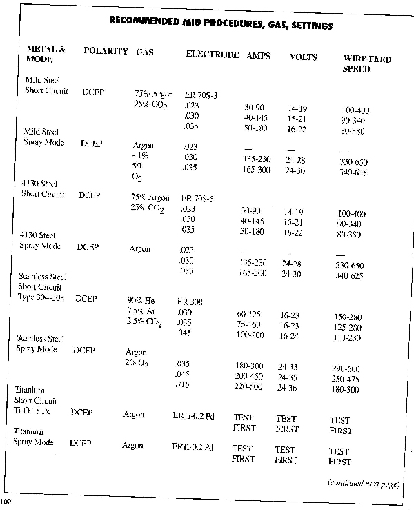

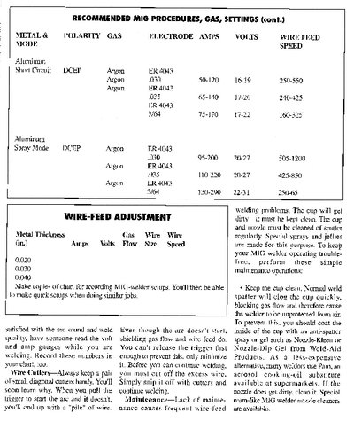

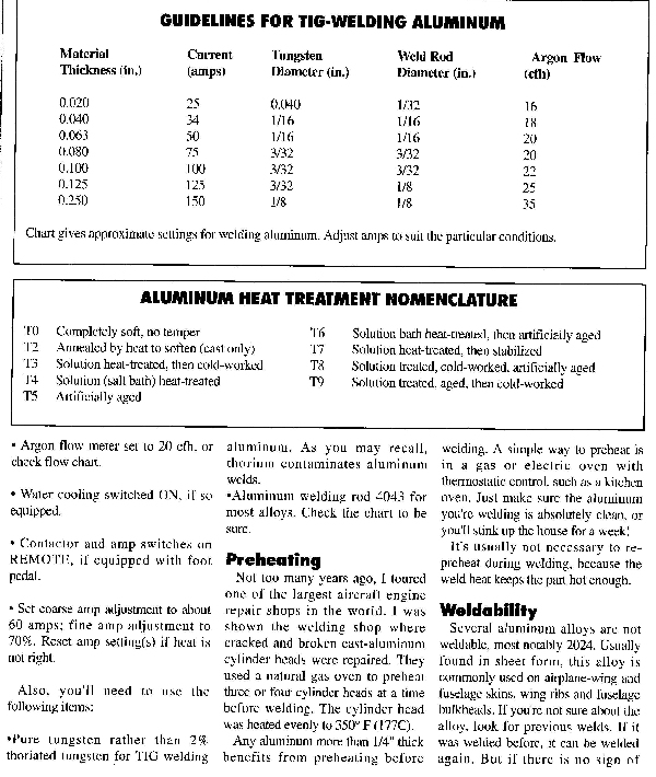

Had to shrink them after I scanned them. Hope there a help to some one.
Welders hand book by Richard Finch Great book
