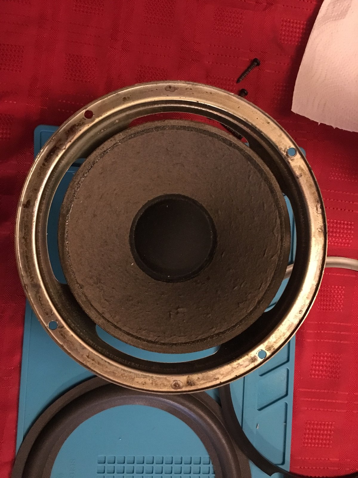

As they were when I got them:
Old foam removed and cleaned up:

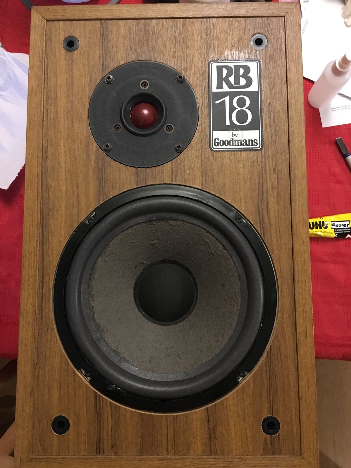

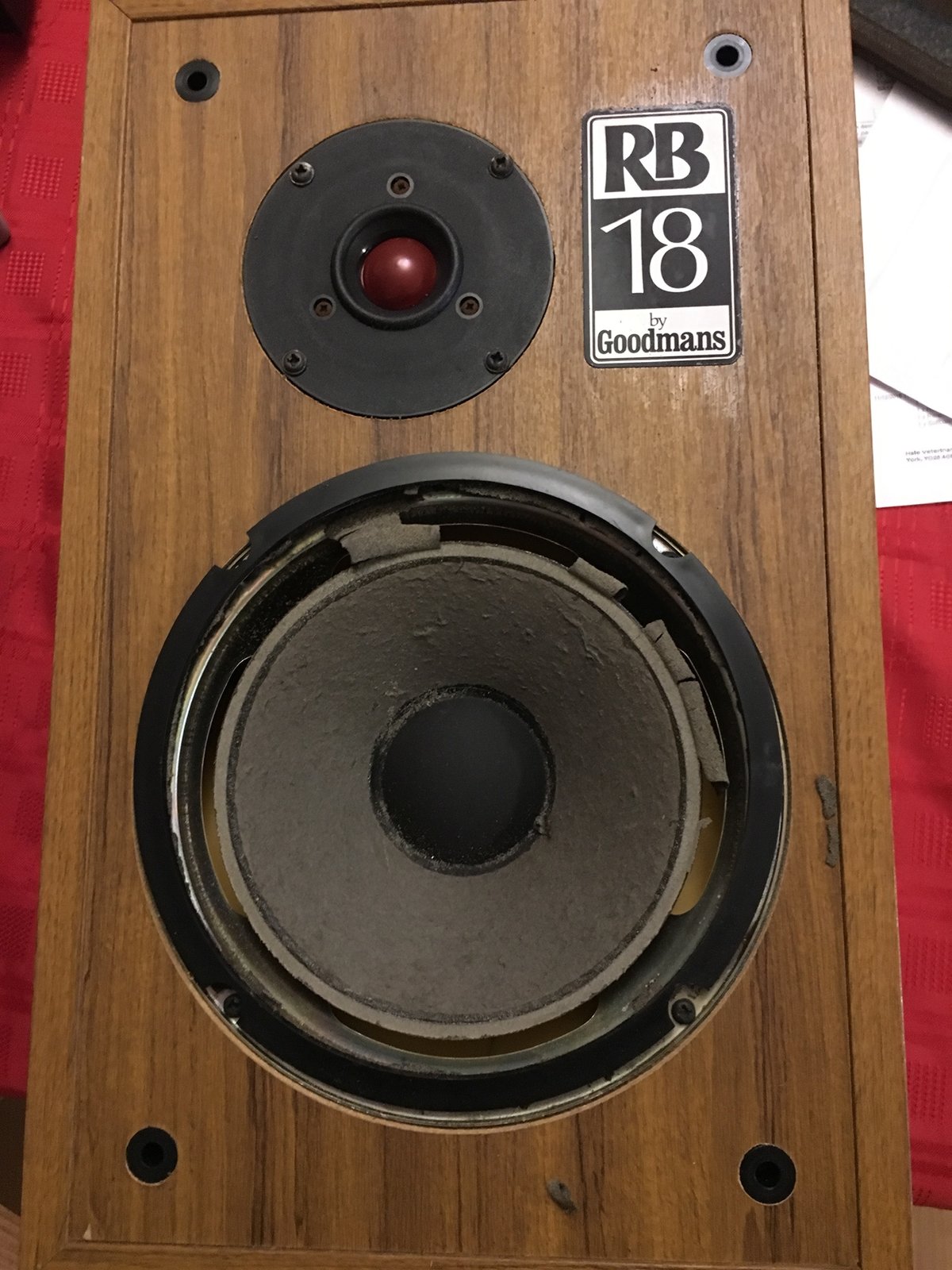

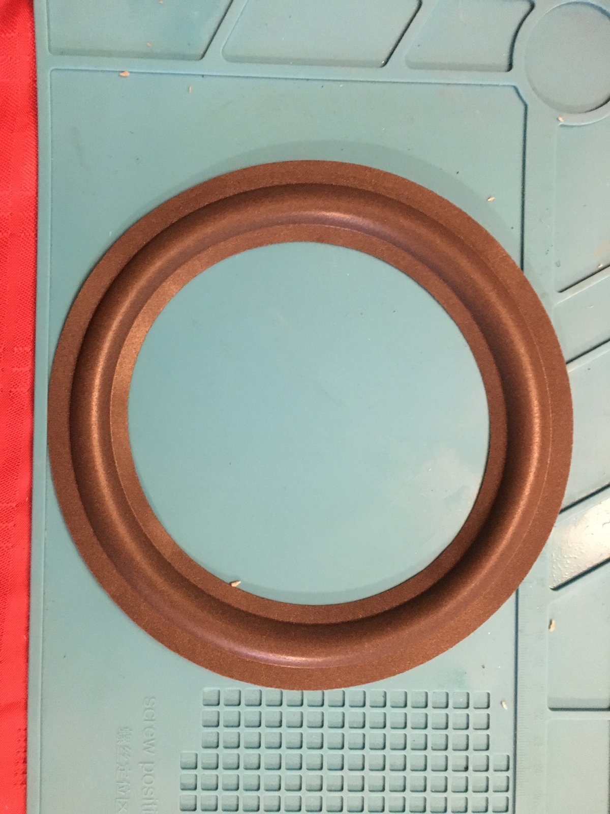

New 8” surround, bought 3 from China for £2.82 posted.

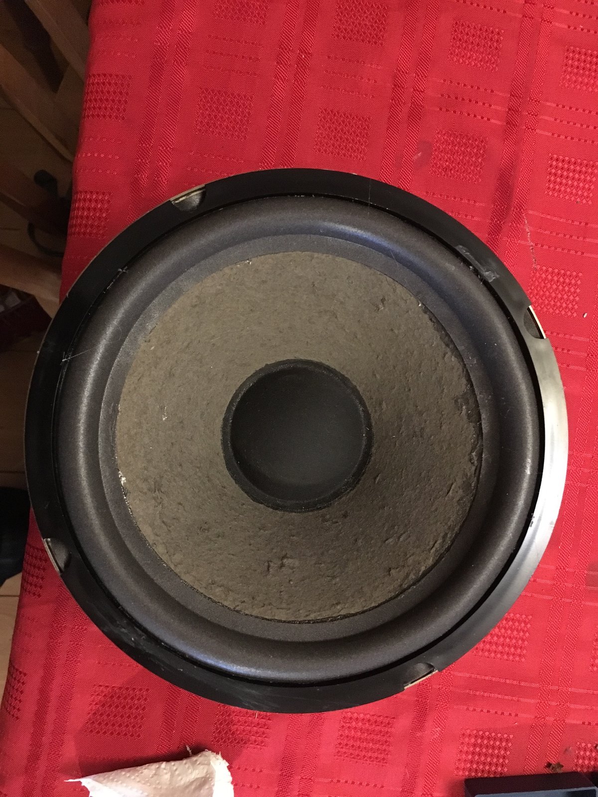

Fitted:
I applied a small voltage to the speaker to extend the cone and make it more rigid to work with.
